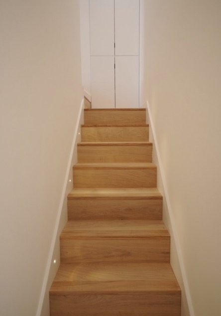

Newer stuff, trimless LED fitting, stair lights etc

Trimless and stair lights,

Trimless and stair lights,View attachment 39629View attachment 39630
Lovely install. I am looking at low light stair lights but going to have to fit them on the stair uprights rather than the sides which might cause some mild annoyance when walking up them. So need to investigate that. My other thoughts were a dim LED strip along the sides but I don't want it to look like a landing strip at MEN.

My install was done by another electrician as if was a flat rebuild that I did, you can integrate an LED strip to the underside of a handrail on the stairs or there are other options.
