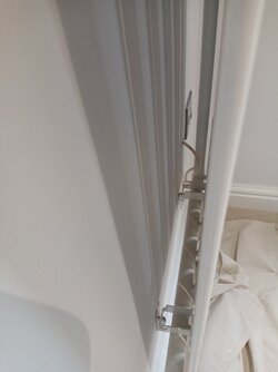

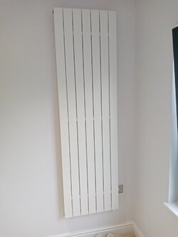

I am sorting out a few problems in a fairly new build (3 years) no paperwork or instructions came with the property !!
a couple of the heaters pop and fizz, so I presume the builders stored them the wrong way and some oil drained out

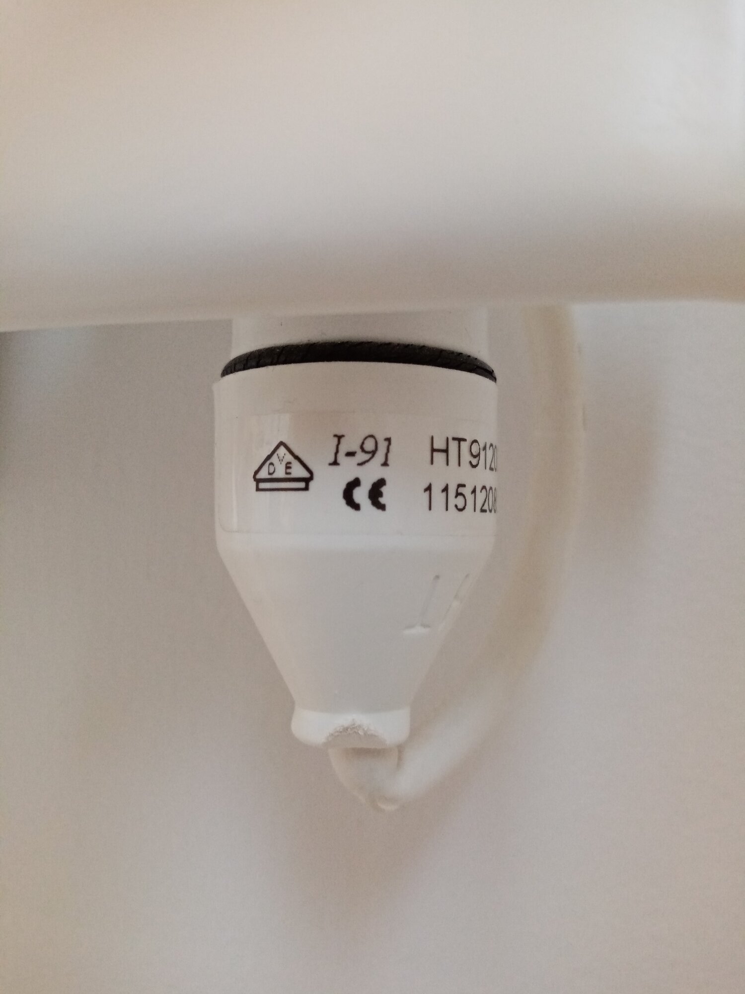

the biggest problem is that I have no idea of the manufacturer of the units, and their is no plate or make any where on them
All I can see on the heating element cover is the following
HT912000
W1200
V230
11512085001 01 16 IP64
any ideas as to the manufactur or supplier

I don’t think they are oil filled.
they look like vertical water filled radiators with a heating element option that makes them electric radiators.
if that is the case, they should be filled with water and a corrosion inhibitor as per the instructions.
As per James post.
It's a 'dual fuel' radiator that can be plumbed into central heating, or used with an electric element, or indeed both.
Such as this (not your exact one):
The element can be replaced if there's a problem with it
(just an example) SIM - Electric Element 1200w Standard - https://ukradiators.com/sim-electric-element-1200w-standard.html
The rad should be mostly filled with water, but not completely. With a 1200W element you might expect to hear kettling noises - I'm not sure if this is what you mean by pop and fizz?
If in its present state you are happy to run it for a while, see how high up the 'fins' get hot. If they're hot to the top, or near the top, you have enough water in it. If only hot half way up, or less, it needs topping up!
Is it leaking? If from the vicinity of the element, that definitely needs replacing! I had an instance where the element developed a leak that put water inside the cable which eventually leaked into the fused spur and blew the fuse!
An electrical test of insulation and current drawn would help establish if there's anything untoward.
If you are competent and feeling strong, you could disconnect the cable, turn the radiator upside-down, undo and withdraw the heating element and inspect it, replace it if necessary, and also check the water level.
If going this route, I would recommend fitting an element that has an integrated thermostat, which can maintain a more even temperature (unless you need to run the thing flat out anyway?)

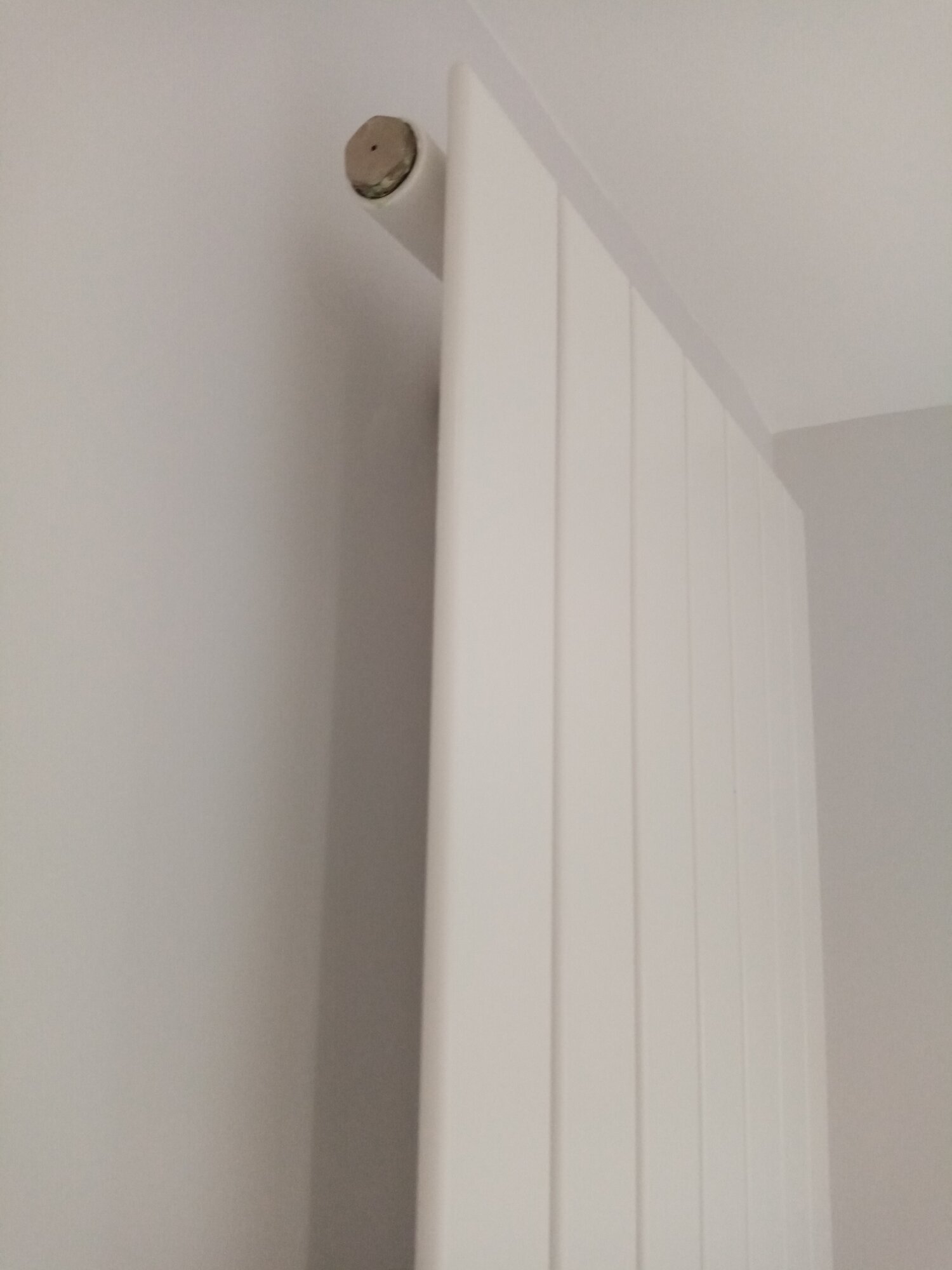

I managed to lift two of them of today, and at the top they have a small vent hole, with a I presume a safety valve, and traces of mineral oil are evident around that area

Thats why they are not filled full - there's always a substantial air pocket present. Hence my comment about not filling it full! I should say I've never seen an oil filled one of this style.
The small vent hole is a bleed valve for when the unit is used as a traditional radiator.
