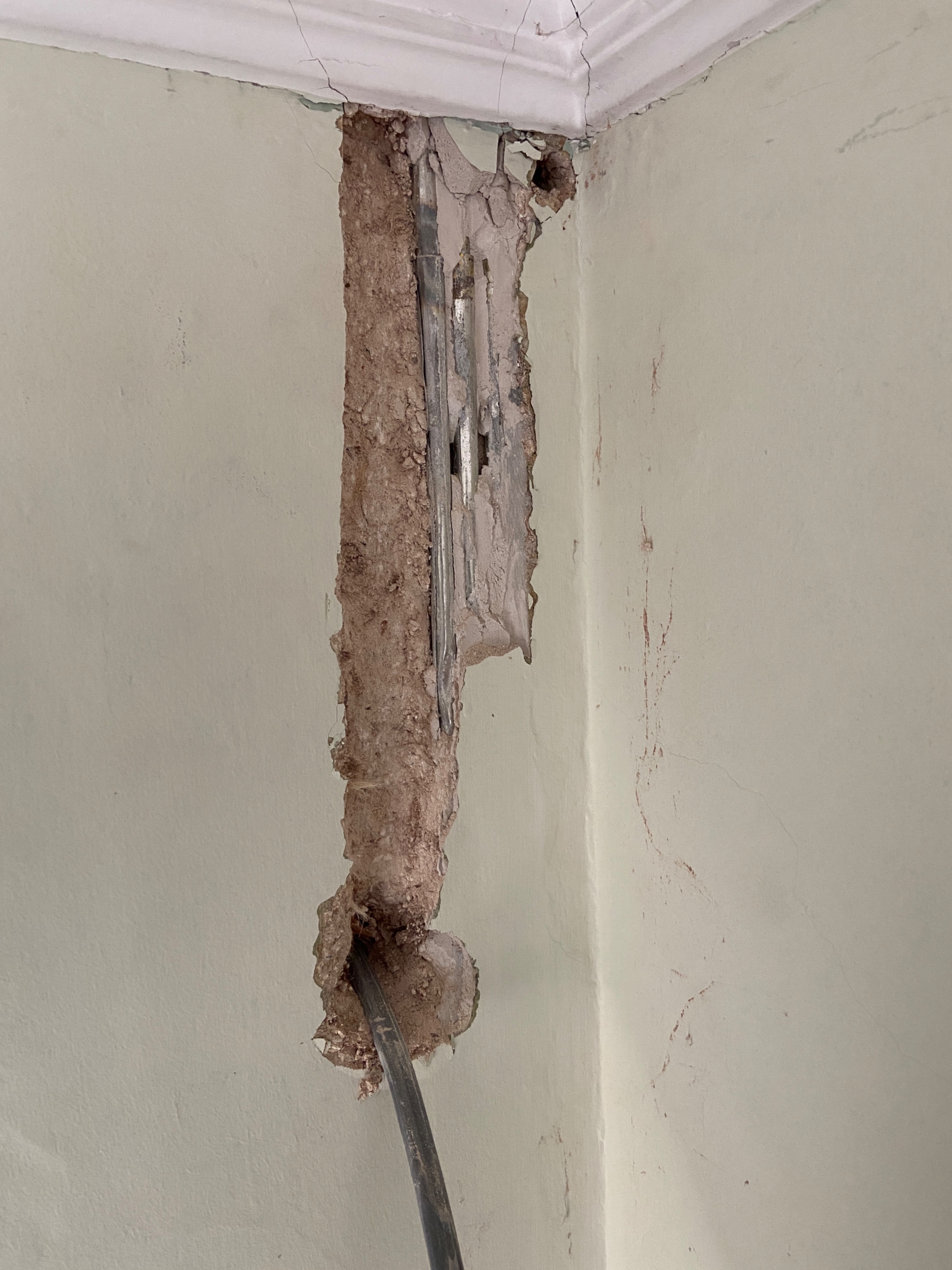

Running a cable in the old stately home I work in sometimes. Due to a change in ceiling height, I’ve drilled through somewhere below the ceiling in the hallway.
Chipped away at the plaster and found these 3 pipes. Ok, they’re not electric for lights and sockets…. That’s in either steel conduit or MICC.
So that gives a choice between either old gas pipe for wall lamps, or a conduit for the room bell call down to the cellar…. Which is an elaborate system of handles, levers and a bell in the butlers pantry. (Never heard it ring) which in places has been replaced with bell wire and doorbell push buttons…. Which also doesn’t work.
Answers on a postcard
Edit: It helps if I attach the photo
Are they pipes? It looks to me as if there's a split all down the one side or was that you being a bit over enthusiastic with a multi tool?
Agreed looks like a longitudinal split (by design) in the tubes but more intrigued by the what looks like a heat treatment to the joint of 2 tubes on LHS?
Call system.
no multitool involved... but it might have had a slight knock with a hammer
I am tempted to say call system..... there is evidence of it elsewhere.... but ill have a good look when im in the attic.

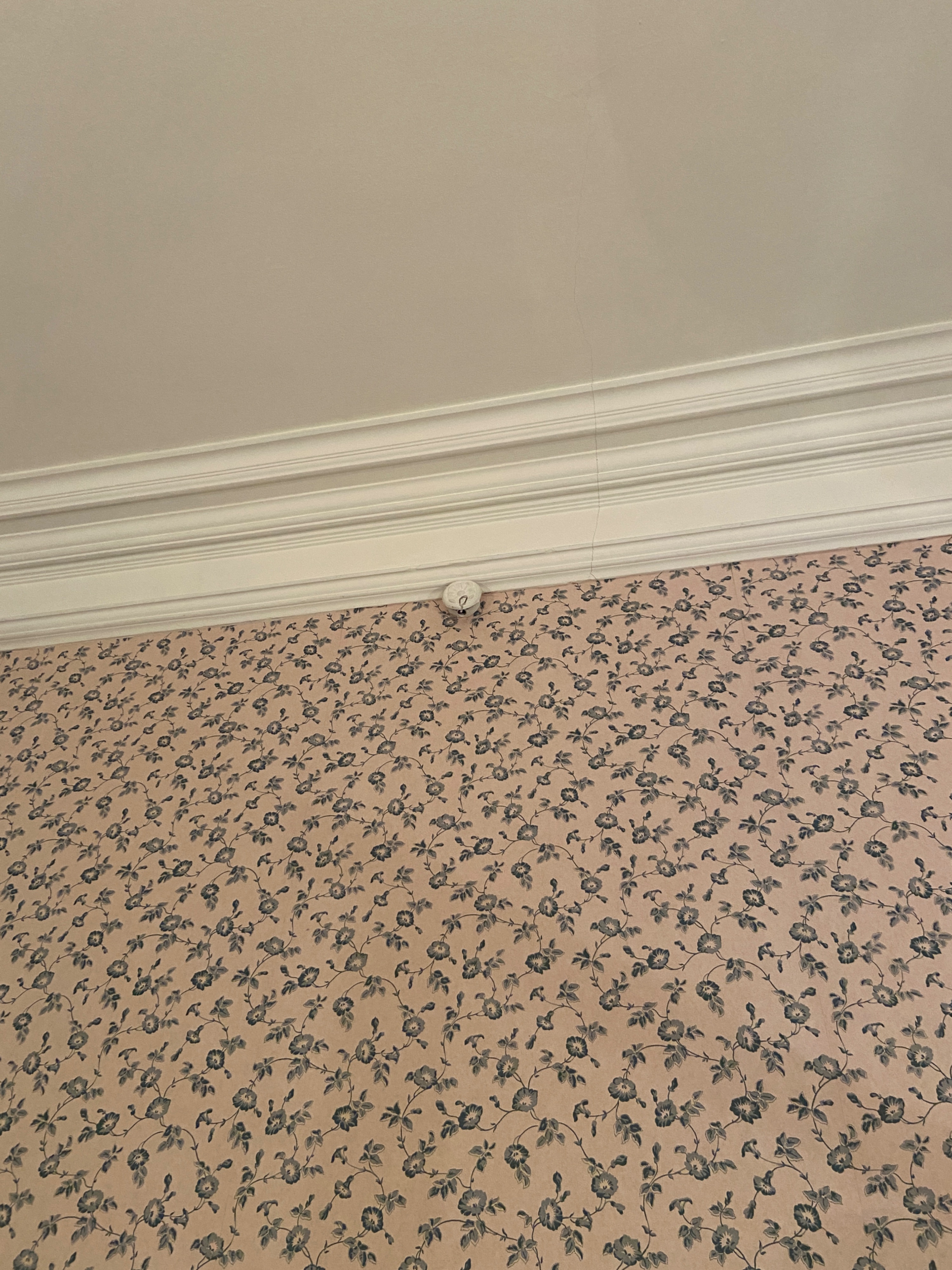

Crawling through the attic today, and I found the old servant call wires.
This is directly above one of these roses… which would have had a pull cord in the olden days.
