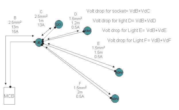

Hi,
I'd like to install electric to an outside deck I have, supplying three brick lights and a weatherproof socket. It's about 13m to the point where a weather proof junction box is required under the deck, then another 1.5/2m to each fitting. The total wattage of all the fittings is 3240, given that a 13amp outdoor socket is 3120 watts and the lights are E27 lampholder max 40 watts each. I used an SWA calculator and It came back saying that I can use 2.5mm 3 Core SWA? Which means I'll need to install a 13m length of 2.5mm 3 Core SWA, buried 600mm deep, from an outside junction box on the external house wall to a bigger outisde junction box underneath the deck where I can spur off to the 3 lights and the socket, in a radial. Can I use 1.5mm to the lights from the deck junction box? Obviously I need to run 2.5mm to the socket. Does this all sound like good practice?

According to Table 4D4A p338 in the 17th I could use 1.5mm SWA everywhere because the design current load is 14amps (3240w/230=14.08A) which would make 1.5mm 3 core swa ok as it's max is 18A. Even the 2m drop from the CU could be in standard 1.5mm because according to p334 1.5mm t & e max load is 19.5 clipped direc. I just love talking to myself...
You also need to work out your volt drop for the load, which is probably why the calculator said 2.5mm2 SWA.
You can split the volt drop so that you can see if just the lights can be run on a lower csa cable.

Maximum volt drop for lighting is 6.9V; for sockets 11.5V; the 1.5mm2 does not make it for lighting.
If you calculate the volt drop for each section then the lights may comply using 1.5mm2 for the lighting.
See the diagram below.

Appdx 1 in the OSG suggests using 100W minimum for each light fitting.
Maximum OCPD for lighting with ES lamp holders is 16A (559.6.16) also the fittings may not be rated for taking the current that maybe expected from a socket. Does not need a switch but does need a fuse.
Ok, so your saying my lb = 15 Amps (rounded up)
13amp socket is 2990 watts +
100w(0.5A) for 3 light fittings 300 watts = 3290 watts / 230 = 14.3 Amps
Following the diagram, Volt Drops would be:
17th p339 2.5mm 3 core swa voltage drop per amp per metre = 15
17th p339 1.5mm 3 core swa voltage drop per amp per metre = 25
VdB 2.93 = (15 x 13m x 15A (Total load))/1000
VdC 0.2 = (15 x 1m x 13A (Socket))/1000
VdD 0.02 = (25 x 1.2m x 0.5A (Light))/1000
VdE 0.02 = (25 x 1.5m x 0.5A (Light))/1000
VdF 0.03 = (25 x 2m x 0.5A (Light))/1000
Socket Vd = 3.13V
Light D Vd = 2.85V
Light E Vd = 2.85V
Light F Vd = 2.86V
Lights are way under 6.9V as required and power way under 11.5V so that would be acceptable. Just out of interest I did these calculations using 1.5mm throughout and added on the forgotten 3m drop from the CU in standard 1.5mm two core and earth. Am I right in saying that I could do it in 1.5mm straight from the CU, that can't be right can it. Something wrong with my calculator possibly...?

As for overcurrent protective device I am required to use a maximum 16A as said which Is fine because I have a new board with a spare Type B 16A 30mA RCBO 61009-1.
Only thing is I know that the regs page 426 and table H2.1 p174 OSG say A3 Radial 20A OCPD 2.5mm Minimum live conductor.
Calculations allow acceptable use of 1.5mm 3 core swa throughout the circuit, however like I said my calcs could be wrong and regs state 2.5mm throughout...but picture shows socket radial serving 20m.
It looks that I could.
