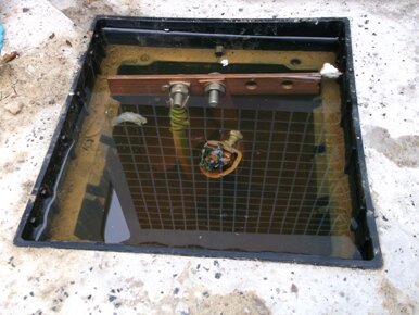

Found this following a generator install, is this a pass or fail? what condition should these earth rod containment systems be in? is the a regulation? [ElectriciansForums.net] Pass or Fail[ElectriciansForums.net] Pass or Fail
Found this following a generator install, is this a pass or fail? what condition should these earth rod containment systems be in? is the a regulation? View attachment 10709View attachment 10710
Why would you want to fail these purpose made earth rod pits?? The only thing i can see that needs improving is the protection of the actual cable connection to the rods. and to the connections to the earth pit bar. Something like ''Denso tape'' (preferred) or self amalgamating tape around the rod connection and the bar connections. The earth pits don't need to be waterproof, in fact it helps if water can enter and seep through down to the ground where the rod is positioned. Though in this case it seems the water is trapped in the pit.
So, not a fail but could well do with some comments. Such as those pointed out above and maybe some holes drilled in the base of the pit to allow water to escape. Both these earth pits should have covers of some sort over them, even if to just stop the leaves getting trapped in them ...lol!!!
I was thinking that the water could probably do with some salts being added, to increase conductivity.
I take it that this is a TT installation, and the rods are not for the lightening protection?
Thats what i mean i wouldnt fail, would it need improvement to a bs7671 (code 4) or requires improvment (code2?) , yeah its TT. theres four of these surrounding a generator.

They shouldn't be filled with standing water mogga, the water should be able to leech away over the rod. This pit looks as if its been set in concrete and escape of the water at best, far too restricted if not impossible... But nothing a few drilled drain hole won't fix...lol!!
