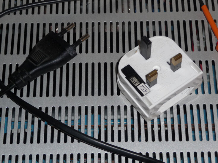

I have a commercial customer who i noticed is using some IT equipment which has a class 2 leads and a slide on 1363 plugs. I guess when the equipment came it may have had different ones for each country of use.
My question is, can they be used for commercial use as they have no fusing.
I've seen this for the plug in transformers but but they tend to have thermal trips but not on leaded equipment before.
Yeah sorry did not take a pic.
It was really just a figure 8 lead (class 2) 1.5m long without fusing. It had an interchangable plug on the end for each countries use and in this case was using a plastic 3 pin 1363 type. You must have seen these when you get a new phone charger.

Like this...
The ones I've seen are fused.
No, if you check out the picture i linked its the same. a moulded plug that takes different pinned adapters for each country and you slide it in place but no fusing at all. I have only seen this type for phone chargers which are transformed and never on the end of a mains lead

If there is no fuse in the plug or the equipment the closest protective device would be in the DB, so in the event of a fault on one piece of equipment you'd lose all the power on that circuit, and the protective device (probably a 32A MCB or RCBO) may not adequately protect the size of cable used.
Does this plug arrangement comply with BS1363 as required by law (the plugs and sockets etc (safety) regulations 1994)?

Well what does it say on the plug? Does it have a BS number or kitemark?
Considering it doesn't contain a BS1361 fuse I would imagine it doesn't.
Ah, I think I know what you mean.
I suspect there will be protection in the bit that slides in or whatever it is powering, internal fuse, perhaps?
Any adaptor which allows a non-fused plug to be connected to a BS 1363 socket must contain a fuse to BS 1362 (or 1A BS 646 fuse in the case of an adaptor specifically marked for shavers). If the device itself is a plug with interchangeable pins and is intended to fit into a BS 1363 socket, then it must meet BS 1363 and be approved, no plug without a fuse could have been approved and would therefore be illegal.
