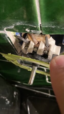

This is the switch ...

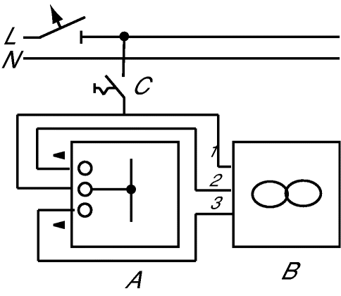

and the connection diagram

But I haven’t tried again to remove to top, rotating element and checked the connections back. I will do that for sure.
On thing that I understand from you comments that, considering that the fan is not working with this configuration, it sounds a bit normal to have this ghost voltage. If I connect switch one of the black with brown, I get one speed, the fan is working. While It is working I should 0 on other connections, am I correct ?
Or is something very mysterious got broken recently (not found yet) and it is messing up all my grid?The thing is .. everything on the same line is working but ı am not sure ıf they are using the power from where this (! )brown connected...

Do you have any information about the old fan eg. the equivalent connection schematic?
And this is the connections on the switch.
As expected, brown in the middle ….
But i am confused… where this voltage come from ?? and is there any chance that the switch has some issues on the connection of brown ? .. may be corrosion ?

The question is: Where does the brown feed to the switch join to the L3 feed to the Perilex outlet? I suspect that this is the bad connection. If so, we might expect that the ghost voltages on the blacks and the floating section of brown are being picked up by proximity to the switch brown which is fully live even though the Perilex L3 is not. At the moment I am not particularly interested in those voltages, only in the lack of a feed to L3.
Perhaps there is a junction box between switch and outlet, or is there another switch that might contain the junction. How would you turn the fan completely off?
