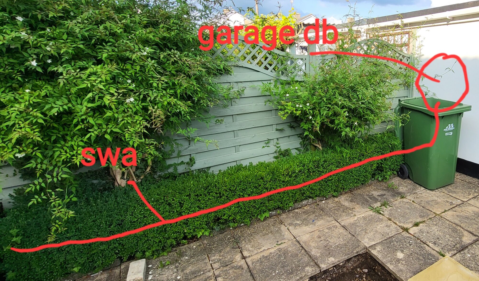

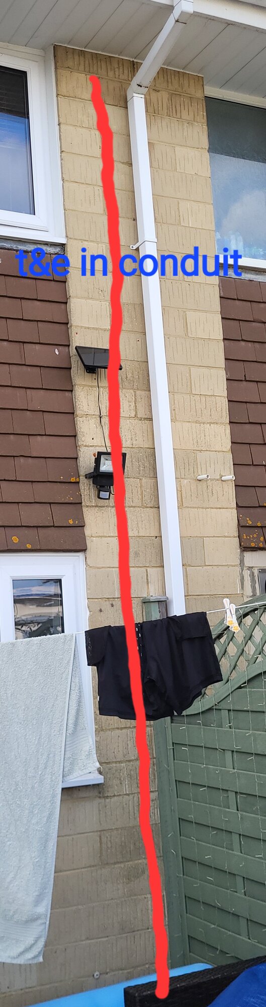

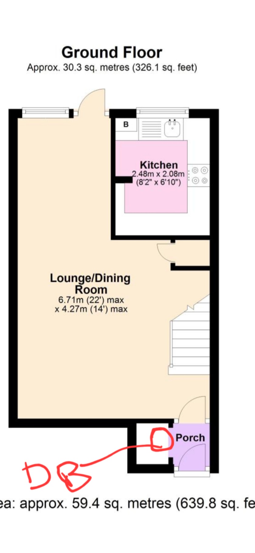

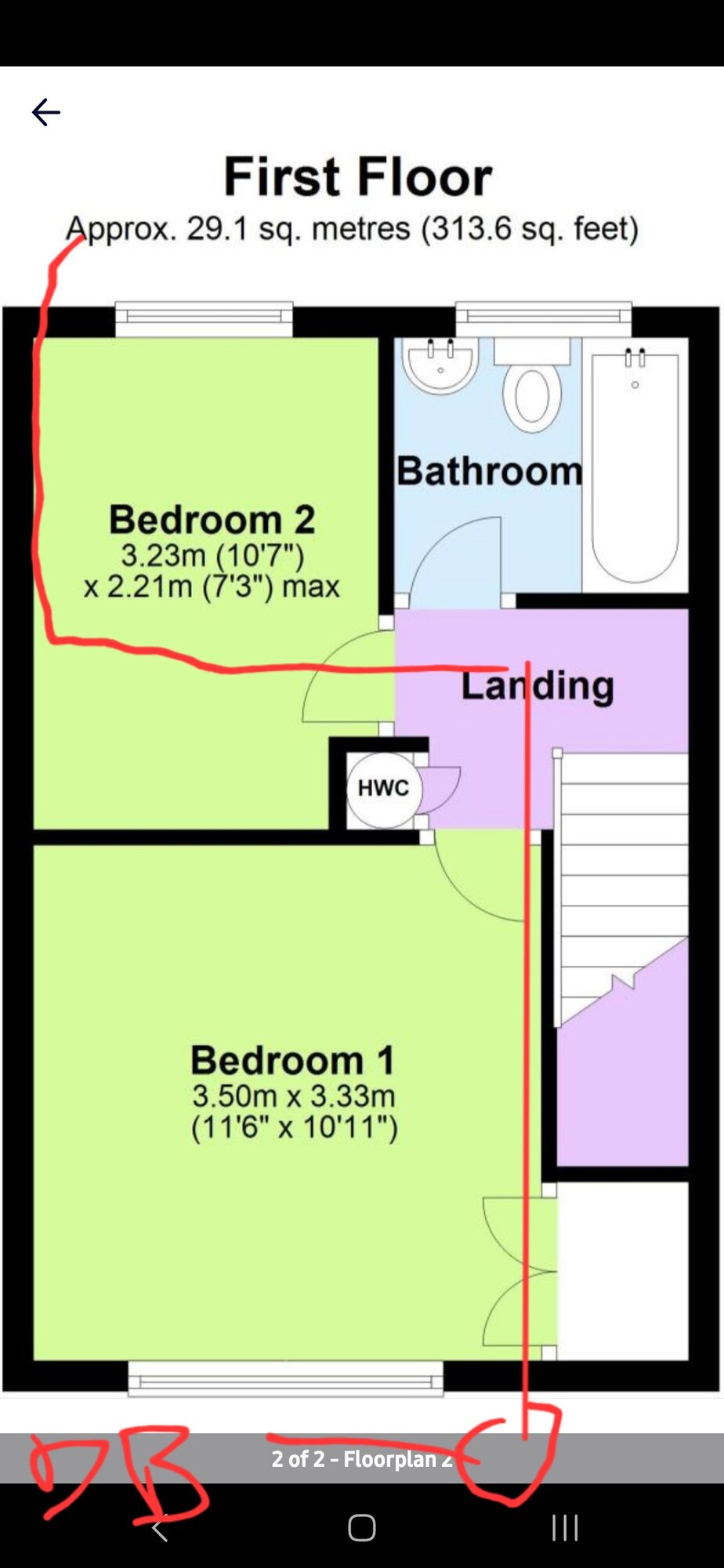

Cheers for the replies, much appreciated.
So the db is in the porch on the ground floor (highlighted red) and the first floor pic with red lines is my proposed route going under the floor boards or up into the loft.
