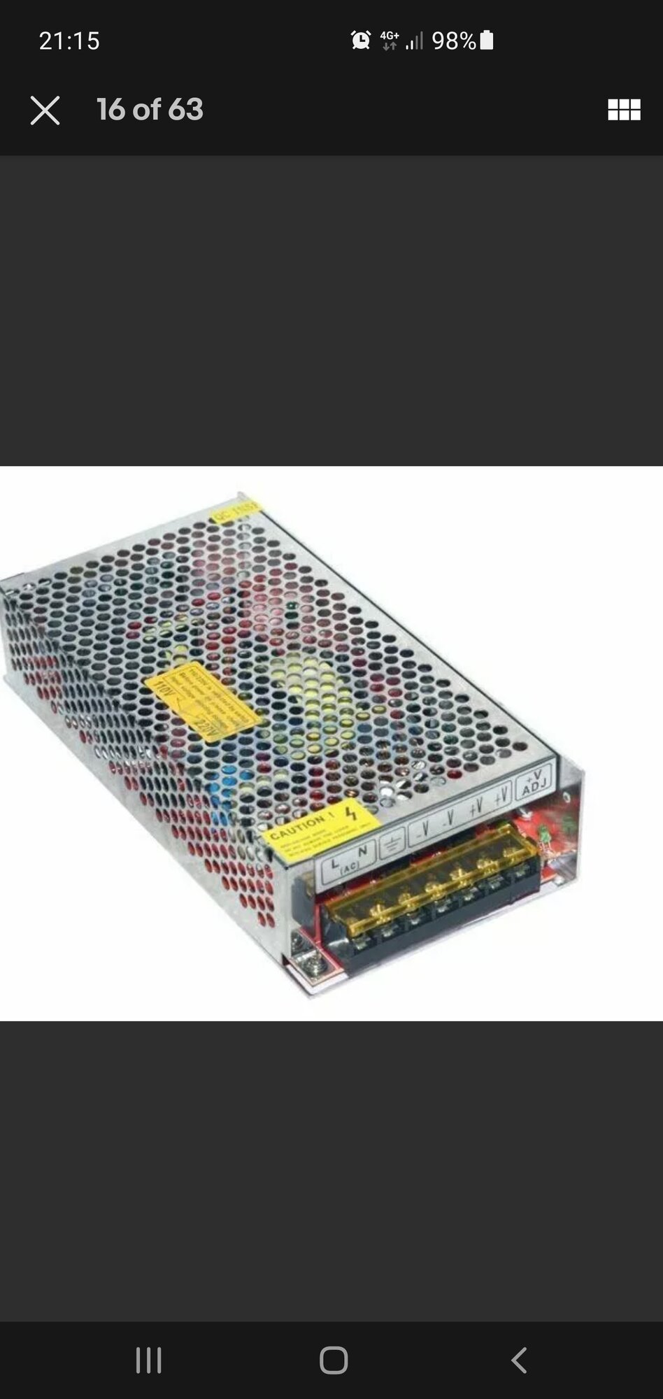

Hiya, just a quick question, i have bought a 240V AC to 12V DC power supply (12v 10A 120W) i will post a pic of it, im looking at runing some 3 core flex with a standard uk plug on the end to the power supply for the live feed, what size fuse should i put in the plug?
thanks in advance :)

Its important to remember that a plug top fuse is just a rewireable fuse that's convenient to change and shouldn't be confused with a HRC fuse...
15
The same socket can be used for different appliances, such as kettles... which will draw more than 5A The size of the cable determines how much...
