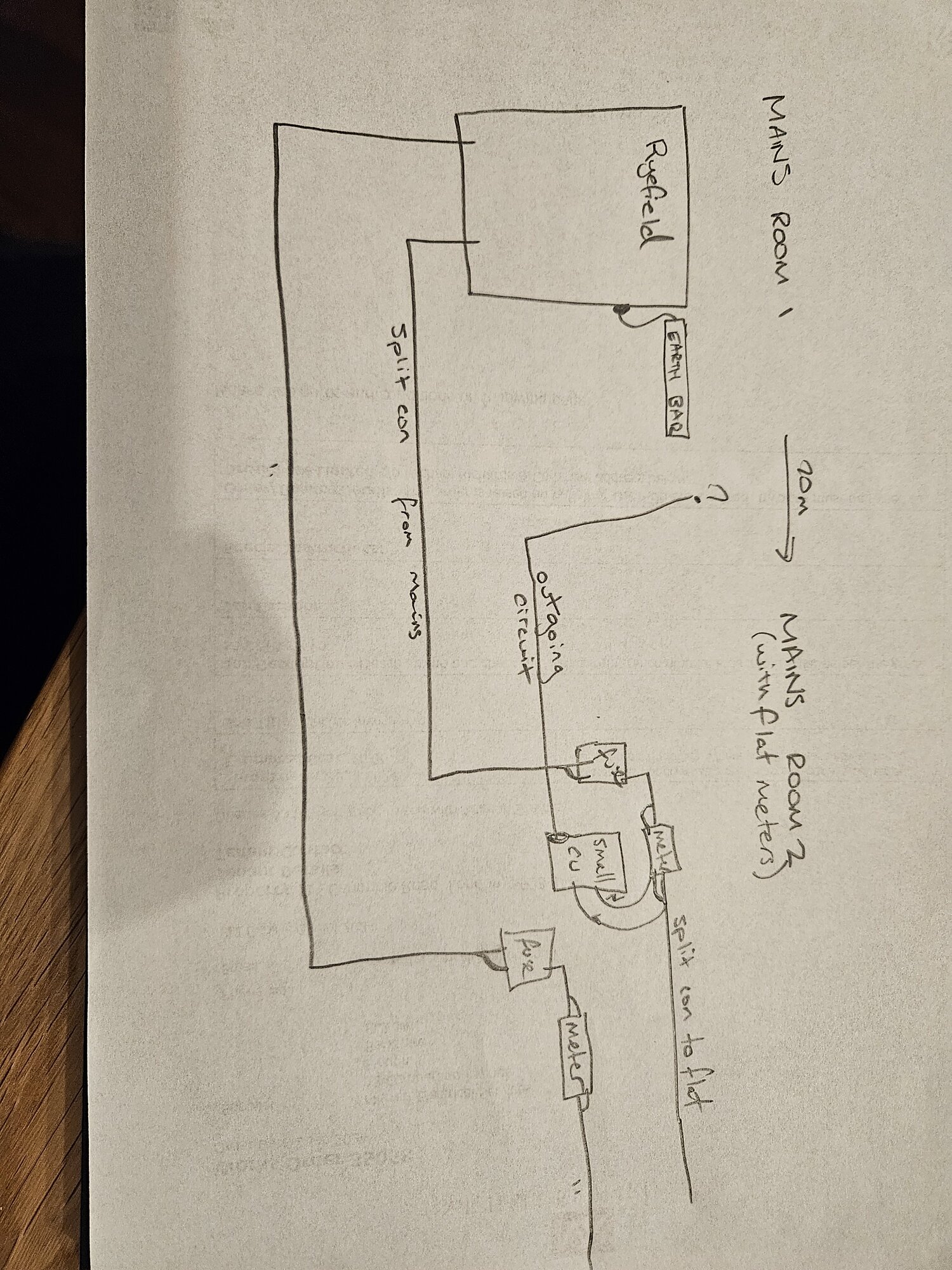

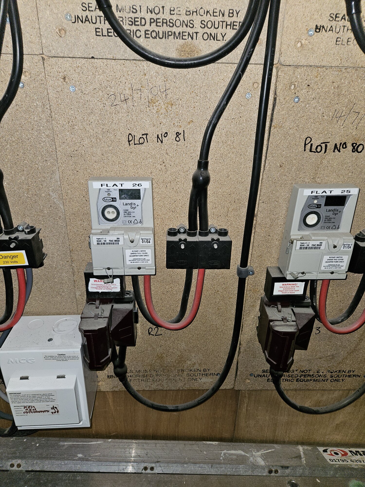

Afternoon All,
Just pricing up a job and thought I'd pick your brains.
Quick run-down, Block of Flats with an underground car park. In the mains room each individual flat has a supply ran up to the flat (picture for reference) with a split concentric. The PME connection is provided within the flat via a connection at a Solid Link Fuse (typical house service fuse block) via the N.
So I need to install a sub mains next to the fuse in the mains cupboard (downstairs) supplying a socket for a hybrid car within the underground car park. My question is can I supply the submains with a TNCS supply via the Henley Block or a link within the Consumer Unit itself, or will I have to contact the DNO directly to provide me with a connection? Not something I have had to deal with before. I have noticed that other contractors have done the same but was unsure if it is the correct way to do it.
Thanks!

The Ryefield Board is in another room yes, there is a small cu next to the cut out.
Put a diagram on here so that we can work it out.
Please forgive my crude attempt lol
That small CU next on the adjacent fuse must have linked N+E within the CU as there are only the L+N tails entering and SWA leaving
  • [ElectriciansForums.net] PME Supply Advice
Bloody hell did a kid do that drawing or are you drunk. Lol
CU in, earth's back to the Ads. That probably needs doing.
That's going to cost some pennys.
