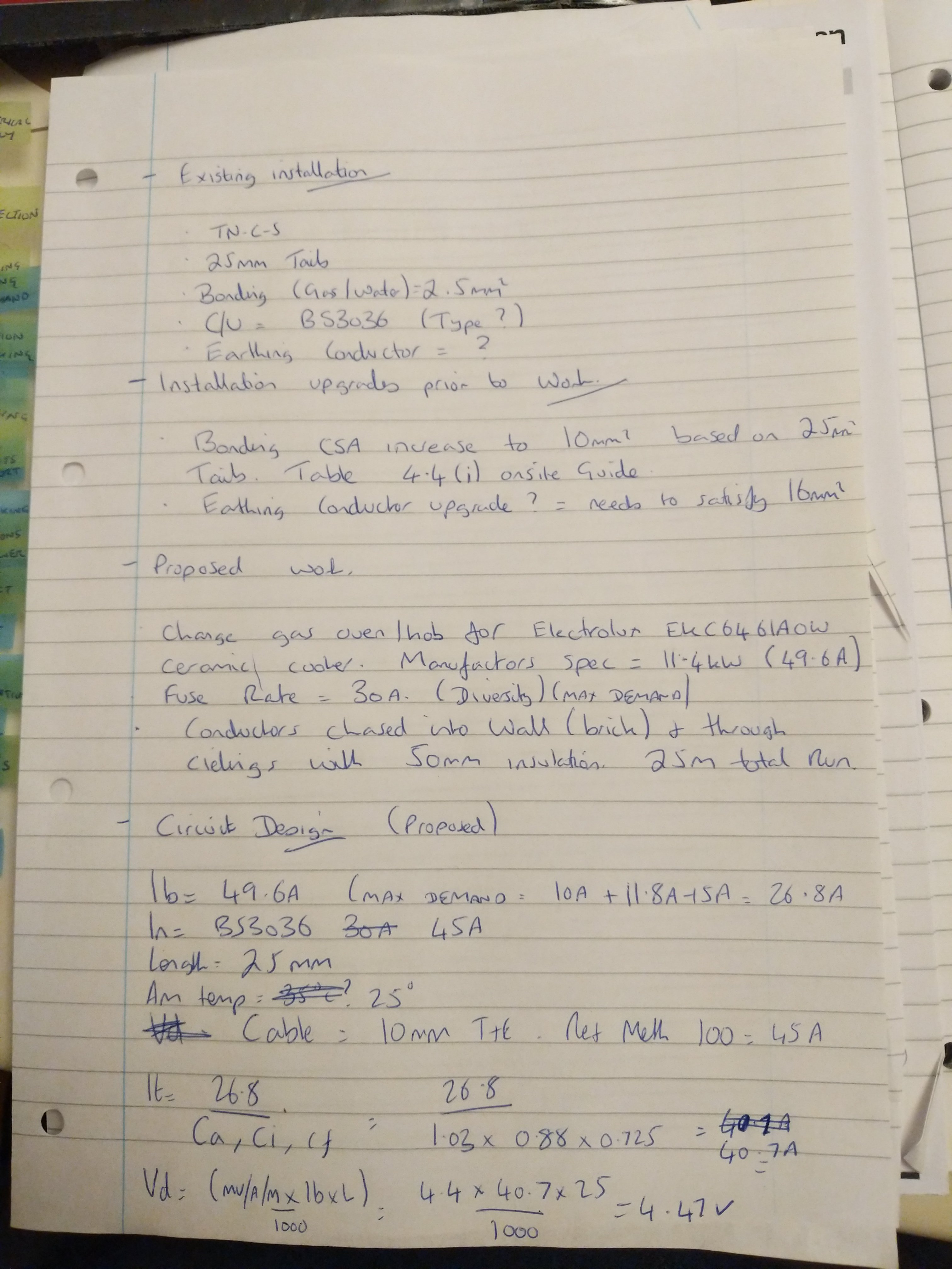

A customer wants to change their gas oven and hob standalone unit to an all electric one. The oven they are installing is an Electrolux EKC6461AOW Ceramic Electric Cooker.
You attend the house and survey the run. The CU is a BS3036 type. The installation will be chased into the wall which is all brick and the floor boards are able to be lifted to wire through the ceilings. There is really old insulation in the ceiling and is about 50mm in depth. The circuit will be a 25 meter run. Bonding to the gas and water is 2.5mm.
The customer has asked to not have an isolator installed and wants the circuit connected directly to the CU. If she absolutely has to have one she wants one with a socket on. She wants your advice on if she has to have an isolator backed up by a Regulation, if possible.
The customer would like to understand fully how you are going to do this job and wants to know how what size cable is being installed and what type of cable. The customer also wants to know if there are any other issues that you can see with the existing installation that may need to be addressed and the reason.

Right, I've had a go. Best I could do with the kids screaming around me (the other half is working late)
I know I've made mistakes but it's been over a year since I touched any design scenarios.
Best I could do for now

Can we have a small clue or guidance as to what we are supposed to be looking for ?
You want to define the size and type of cable required to safely connect the oven to the CU. Taking into account the description of the cable run, installation methods, protection type and connected load.
You want to identify any other issues that may need to be addressed. Refer to the description of the installation and identify any problems.
You need to assess if a local isolator switch is required and if so why.
Reference the regulations on isolation and switching.
From your post you have stated that rewireable fuses take more current (than 1.45*In as is used for MCBs) to ensure disconnection on overload so the cable will need to be bigger to not overheat before the fuse goes. This is a good start on defining the cable size.
gazdkw82 has made significant inroads into the
calculation and information that show the approach expected.
Keep on thinking about it and checking the regulations for the items mentioned in the description.
