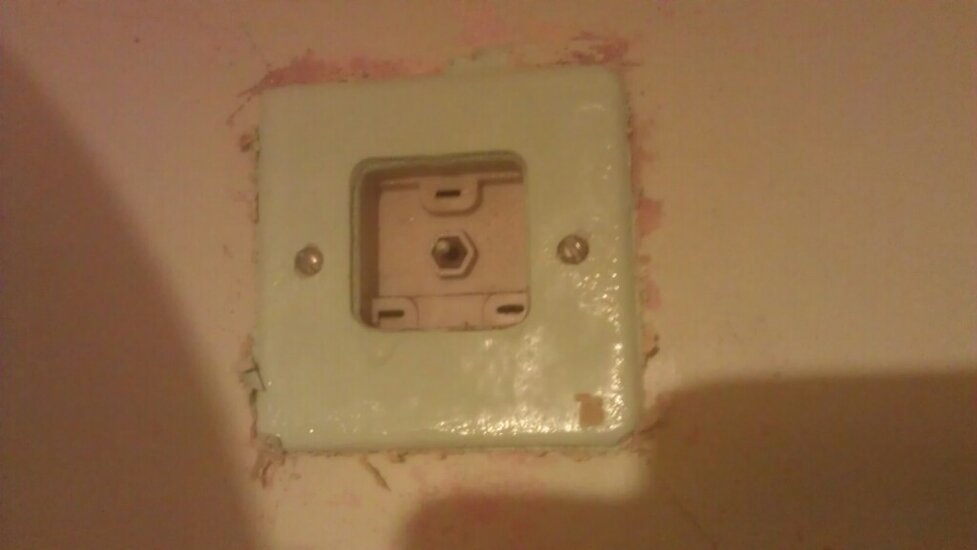

I have a customer who has sent me a picture of an outlet/socket (unknown) in a house he has just purchased, but I don't recognise it. From a second pic it looks like the cable behind is a single 1.5mm or 1mm T&E. I'll go round and have a look later in the week and trace the cable if necessary, but currently my interest has been peaked and I'd like to know now!

Sorry about poor quality sent to me via mobile phone.

I forget the make but I remember ripping some out while serving my time, it had a big rocker in the middle of that plate and was a light switch.
That one's obviously ancient and buggered.
What was the brass pin in the middle for? ~Just an earth connection?
That was where the plug had a thumbscrew on it to hold the plug in
These points were often found above fireplaces or in kitchens above doors ..
Have also seen then on wall above or to the side of windows for the old window mounted fans as well,,
