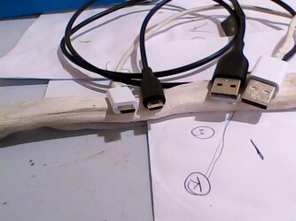

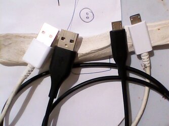

The attached pictures from 2 different angles, show 2 x USB-A and 2x USB-mini-B ? Would you agree? (they are each cables with USB-A on one end, and the two connectors the other end.

That power brick in post #1 will always give out 5V UNLESS you use the usb lead that came with it, and plug that into a device that requires other than 5V, in which case the PSU will communicate with the device, (eg USC-C phone, which you haven't got) via the chip in the cable, and negotiate the charging parameters required.
Don't worry about it damaging your phone. These things are designed to be pretty foolproof (despite being sophisticated, or do I mean complicated?)
