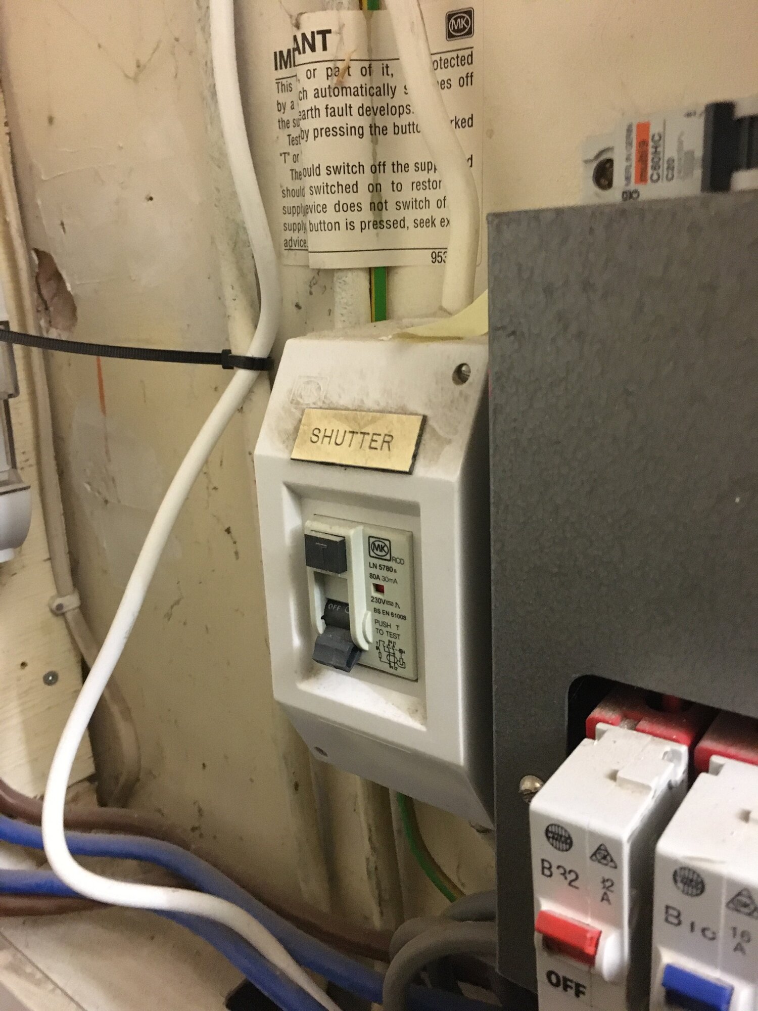

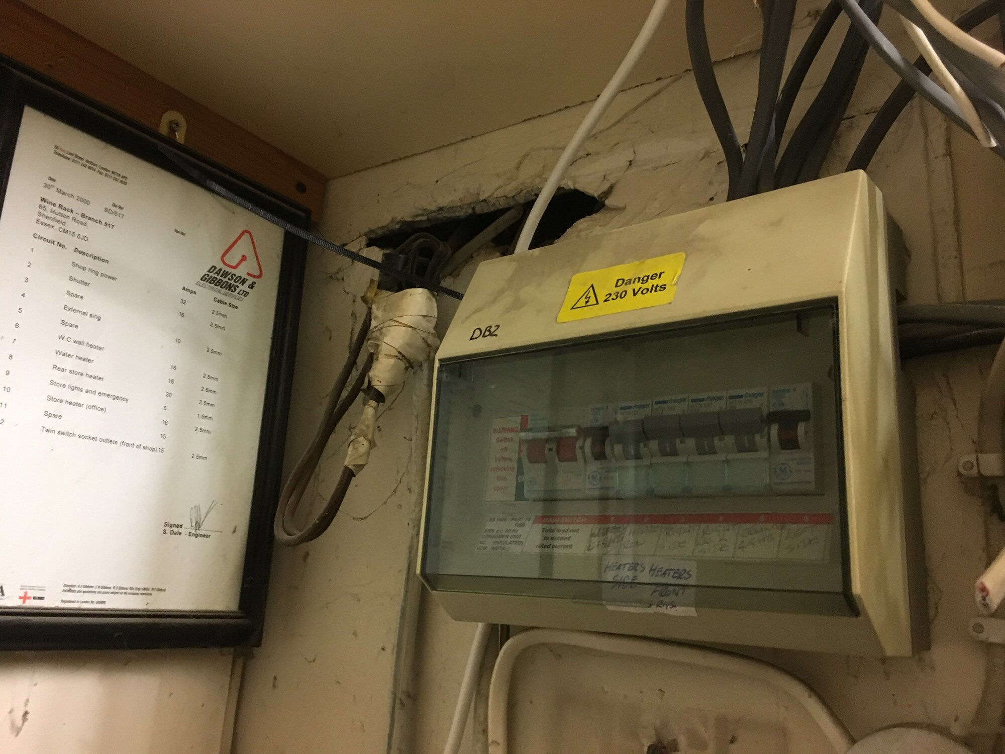

Just having a look at pricing this for a shop
asked the owner to send me some pics of the board/intake
getting that twitch in my nose that says dont go near it
already spotted an instant C1

You can't get much more C1 than a lump of exposed live unfused copper, next to the main switch and earthed metal and all. Could be downgraded to a C2 with a bit of gaffer tape.
Or a man trap, using some of this?
https://www.NoLinkingToThis/p/diall...VAd5RCh3nhgGmEAQYASABEgJ3I_D_BwE&gclsrc=aw.ds
sorry, should be person trap nowadays
