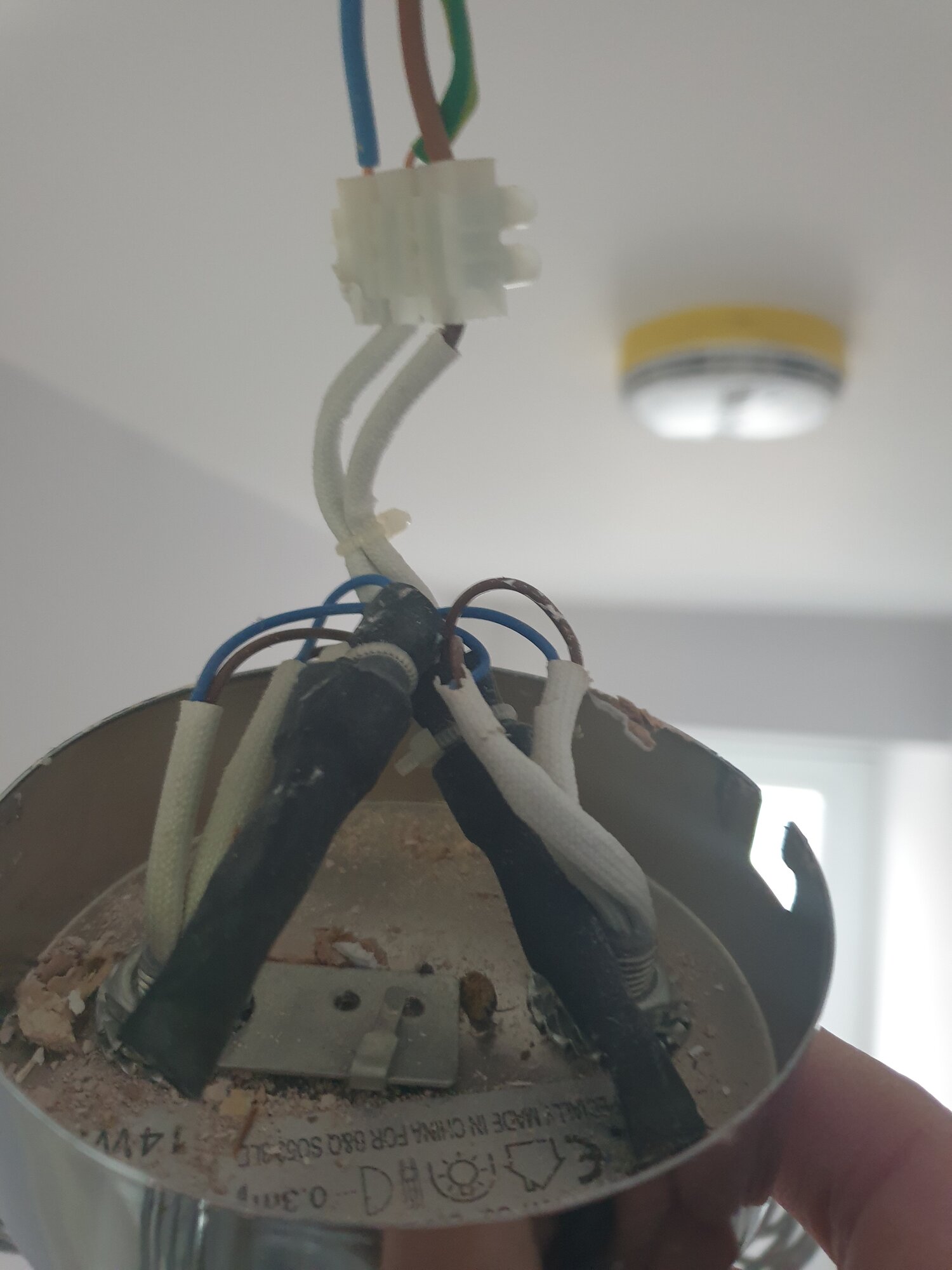

Hi I have an upstairs light fitting and a downstairs light fitting, hall and landing. Upstairs fitting switched on and off by landing switch and downstairs switch. Both fittings were removed for decorating. When upstairs fitting reconnected, only live neutral and earth, and downstairs fitting reconnected, only live and neutral, the upstairs fitting will not now switch on from upstairs switch unless downstairs light is on. Nether switches have been tampered with, I'm baffled? Any ideas please?
I guess you made the novice mistake of no photographs before disconnecting?
If they really are only two wires at each light, and that is all you disconnected, then possibly there is some junction box nearby that has been disturbed by the movement of the cables.
I suspect your most sensible option is to get someone in to take a look at it.
Hi, thanks for reply, here is a photo of the downstairs fitting, upstairs is the same but with an earth
As an aside, the connector block where the CPC [earth wire] is terminated on the downstairs light should be connected to the small metal tab on your light fitting to earth it.
