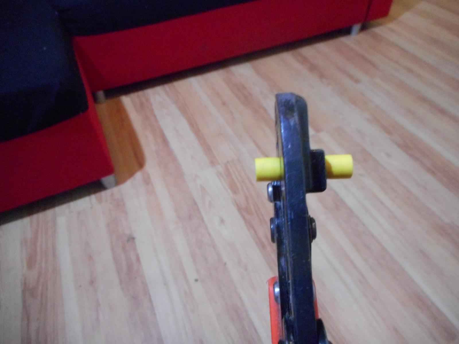

This is only the second time I have had to crimp 6mm cable. I remember the first time a couple of years ago I had problems. Again this time the connection just pulled apart in my hands.
After looking through the forum I can see that others have had the same problem specifically with yellow crimps. 1mm and 2.5mm seem to crimp perfectly well (again seen in other threads), but with 6mm there is a problem.
The reason for this thread is because other threads point to the crimp or the crimping tool being the problem. I have a CK crimping tool which has good reviews and crimps 1mm and 2.5mm very well (I have tested these in a vice), so I believed the crimp to be the problem. I was about to buy some SWA crimps as other threads point to these being good quality. However, my red and blue crimps were bought from the same manufacturer as the yellow so it didn't really make sense that it was the crimp at fault.
I've just been in the shed crimping 6mm in a number of different ways and think I have found the problem. With red and blue crimps you have the crimp flush with the crimping tool when you crimp. I assumed it would be the same with yellow, however the crimping tool is wider for the yellow crimps meaning that when you crimp you are crimping the entire half of the crimp (perhaps even slightly over), meaning that you are crimping down on the piece of metal that sticks out in the middle of the crimp and I think this must be stopping the crimping tool from crimping properly.
The top crimp (see picture) was crimped with the yellow crimp (outer part) flush with the crimping tool and just pulled out easily. With the other two I slightly pushed the crimp into the crimping tool so that the central piece of metal would not be disturbed (you can see that the bottom 2 crimps have a bit in the middle still raised whereas the top one doesn't). I could not pull either of these out when placed in a vice.
Correct crimping is so important I thought I'd mention my little test. I tested the 2 ways each with 5 crimps and it was the same with all of them.

Anything above 2.5mm I'd use an uninsulated ferrule or lug with an indent crimper or if it's a larger size like 16mm or above a hex type crimper then use heat shrink to finish. I'm not a big fan of insulated lugs TBH, they're not very consistent and they're not visually checkable in the same way an uninsulated crimp is.

I've just looked at that crimping tool Simon and there seem to be a few different varieties. Most seem to have the yellow part of the crimping tool flush with the red and blue, but the tipo HP3 has the yellow part sticking out just like the CK crimping tool.

Do you mean this in relation to uninsulated butt crimps Marvo? I'm guessing you must mean the outside of the crimp is visually checkable rather than anything going on inside?
For 6mm it is better to use an uninsulated crimp with a hex crimper than those plastic jobbies.

Why do you feel it is a better crimp when uninsulated (crimping tool is making direct contact with metal rather than PVC?)? Also, why a Hex crimping tool when the conductors get larger? Is this from experience or just known better practise?
Yep thats the ones i have.
A silly question perhaps but which side are you putting the cable in to?

Because you can see when the conductor is properly inserted and can see that the crimp is properly located in the crimp die. Plus the standard uninsulated crimps have a thicker copper tube than the metal of the insulated.
I've stripped the insulation off of a few insulated crimps to have a look inside and they don't inspire confidence.
