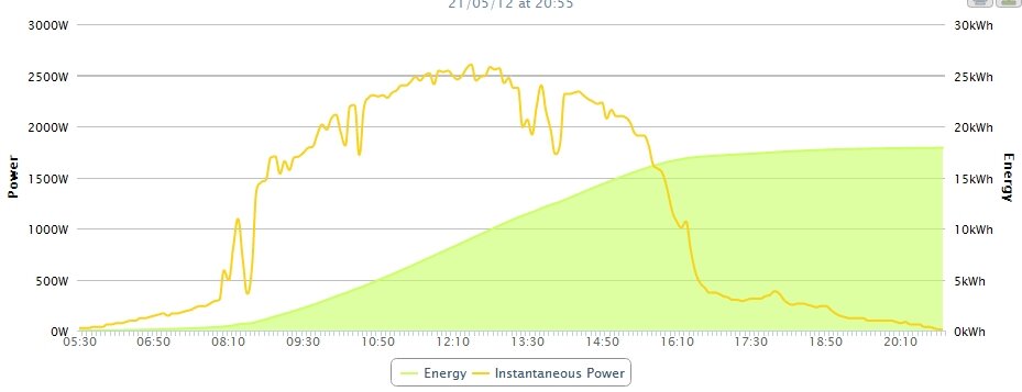

We have a single array of 12 Sanyo HITs ( 240's ) all wired in series and connect to a SMA SB3000HF-30
We have part shade from the East in the morning till 9am, then shade commences again from the West due to trees at 4'sh...... these trees will be no longer very soon :gettree:
The inverter currently runs all the time at around 500vdc and I've never seen it lower than 450vdc, even when its producing approx 0.1a
The question is this ( I assume I have given enough data ) - would we of been better having the panels in 2 arrays of 6 panels each to cater for part shading for an hour or so or will the internal diodes be looking after this anyway ??
This may help..................

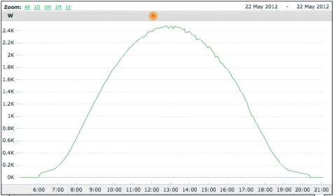

I may be a bit premature here but after day.1 i'm impressed - this does appear to have made a difference !!
