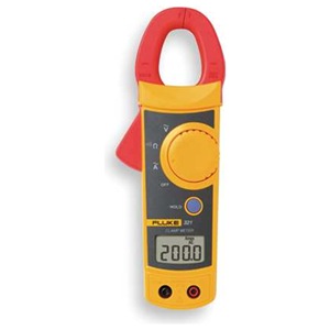

could you use a clamp meter,to either clamp the live and then the neutral to check the current is equal,and none is flowing to earth as this would cause the rcd to operate,or could you clamp the cpc to see if any current is flowing...although im not sure if this would be possible as it would of tripped..
I like this. You might not get accurate leakage readings by clamping the CPC because the current might be finding a parallel earth path through moisture for example.
You could however get an accurate leakage reading by clamping the main supply L+N at the same time which is great because then you can then assess the leakage on each individual circuit by resetting them one at a time. Obviously you can then decide which circuits require remedial action, you define exactly what the circuit supplies and do what Floody suggested and start visually checking.
