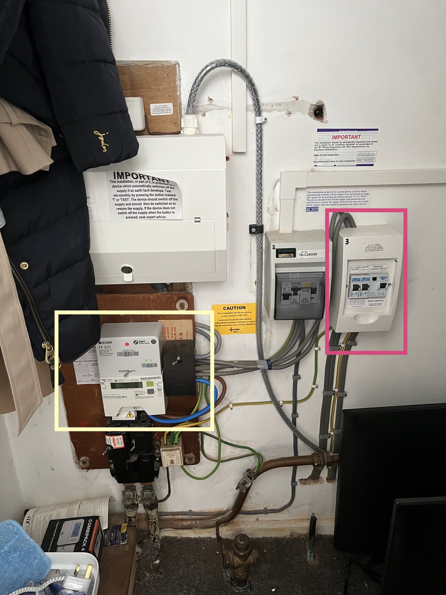

Hello,
Firstly, I'm aware other people have posted similar topics on this forum, I'm not trying to create a duplicate, but more looking for advice as to the distance between my smart meter and the tripping RCD.
I had a smart meter fitted yesterday, and straight after the installation, the engineer called me in and said I had a faulty RCD or a faulty appliance in the kitchen that the RCD box feeds (I'm not an electrician so apologies if my terminology is off here).
Anyway, I flipped the switch back and it seems to be totally random on when it trips. This ranges between minutes to hours.
I decided to start trying to isolate the problem. I unplugged and turned off EVERYTHING in the kitchen except the fridge. This worked for about half an hour then it tripped. So I unplugged and turned off the fridge socket and plugged in the washing machine at the other side of the room. The same thing happened some time later.
I was then told if the appliance was faulty it would trip straight away.
Anyway, I'm currently trying to get in touch with SSE who fitted my meter to get them to check before I pay money to an electrician.
Why I wait, I was hoping to get some advice. Is my meter too far away from the RCD box to cause the trip? Also, does anybody know what RCD make/model I have? I'll attach a photo (smart meter highlighted in yellow, tripping RCD in red)
Thanks in advance
Edit: one other thing to add, the gas smart meter is about the same distance away off to the bottom right of the tripping RCD.
There are two possibilities, first is that something has gone wrong with the wiring off the pink-highlighted RCD and this has only become apparent after the main power was cycled during the installation (or the RCD was stuck and now is free to report it by tripping). Given swapping the fridge for the washing machine made no real difference, it seem VERY unlikely both have similar faults.
The second likely explanation is the RCD is being tripped by the radio transmissions from the smart meter. Some older ones are known to be prone to this problem but I don't know which ones (not something I normally do).
That one is a Proteus, an own-brand from the CEF electrical wholesale outlet. They are not exactly top of any spark's preferred list though they are legitimate brand.
My suspicion is you will need to get in an electrician to check the circuits (for any insulation faults and/or too high leakage), but probably they would replace that RCD with a newer version of the same brand (to avoid replacing the unit - as such assemblies are designed and tested for the same brand's models). I would expect all new units to be better able to deal with RF transmissions!

Thanks for the reply, that's really helpful I've had no luck getting through to SSE due to high volumes of calls (waited for 2 hours) but they've asked me to book a smart meter appointment before booking an Electrician.
Thanks for identifying the RCD brand. I actually work for CEF :p But my skillset ends with software engineering, lol. Appreciate the reply, I will update the forum once I get this resolved.
One last question, do you know if a faulty appliance would always trip straight away or can a fault with an appliance trip after certain durations? I know with it happening on 2 appliances like you said it's unlikely.
Some are notorious for that, typically freezer de-icing heaters that only switch on occasionally so if they develop an insulation fault then the RCD is tripped at odd times and nothing looks untoward when the wiring or appliances are tested.
The fact that two appliances would need the same sort of random fault makes it unlikely it is them. There can be other explanations for bizarre RCD trips such as a N-E fault where it only shows up when something draws a lot of current, but not necessarily on the faulted circuit!
Your check so far in switching off appliances is a very sensible start, beyond that an electrician should do an insulation test on the wiring there (checking both L and N) as one of the first things to rule out.
What you could also try is to put off the two MCBs to the left of the RCD as that would isolate the L side of all related wring. If it still trips then it is either a N-E fault or more likely the RCD picking up the smart meter's RF. But that also removes some of the antenna effect, so if it stops tripping it is not the same as proving it is not RF, if that makes sense.

What happens a lot is loose connections after a smart meter install. They rive about on the cables and they can come loose at the opposite end of where they were working. They are not obliged to test "your" side of the tails so they don't bother. A loose connection like this can cause your RCD to trip. If this has only started happening since the meter install, it COULD be just coincidence, but more LIKELY its down to something they have done. Their work isn't always up to par believe me. They are on a fixed time / price so they don't hang about. Like others have said, if it is an appliance and you want to use a process of elimination, you MUST withdraw the plug fully from the socket outlet. Just switching the socket off could leave the earth and neutral conductors connected and still cause an issue. Appliances can still cause tripping even if they are switched off. It's only when the plug is fully withdrawn that the appliance is fully isolated from the system. When the RCD trips, it's only dead items that could cause a fault so anything that is still working such as your cooker won't be causing the issue. Finally NEVER let a kitchen fitter loose with your electrics. Sockets in cooker hood tunnels, sockets behind appliances that you cant get to, 4g extension leads under the plinth with the plug cut off and wired directly to the 32A ring final are far too common things we see, as is sockets left facing upwards, collecting water under a sink.

Oh, and the use of SY cable (the silver braded see through cable) highlights a bad installer. SY cable is NOT approved for use in BS7671 and is completely inappropriate in your situation there. I suspect a rogue electric charging point company?

I promised I’d give an update in hopes it would help somebody else one day.
So, after much back and forth with SSE they finally sent out an engineer. Straight away the engineer said that it’ll be the smart meter causing the RCD box to trip.
He proved it by calling head office and asking a colleague to take a reading. When they did, it tripped.
He ended up moving the smart part of the meter as far away on the board as he could and it hasn’t tripped since.
It did take me filing a complaint to get this resolved as SSE were telling me I had to pay for my own electrician first. Eventually they agreed to look into it. I was also awarded £130 compensation as this went on for a good couple of months.
Hope this helps somebody one day.

Is that a gas or water pipe? Cables have to be at least 25mm away if it's gas.
Do you mean the pipe along the bottom that has the greenish yellow cables attached? I think that’s gas. The gas meter is off to the right where those pipes go.
I rent the property so not sure on the exacts, but my landlord does send out somebody to service my boiler and he does go into that area.
That 25mm distance is another meaningless regulation.The gas pipe is already part of the electrical system by virtue of been bonded to the MET.

OSG pg 25: 'Where gas installation pipework is not separated from electrical equipment or cables by an insulating exclosure, dividing barrier, trunking, or conduit, the following separation distances shall be observed:
a) 150mm away from supply equipment and
b) at least 25mm from sockets, switches, supply and distribution cables.
BS7671 tells you on page 152 that BS6891 tells you what to do in this instance. BS6891 tells you the same as the on site guide.
It's a requirement that we're not just allowed to ignore.

Had somebody ask me about this recently, all the cases i I have heard off have involve mem 2000 rcds for some reason! only when he said to his supplier if they didnt come and move the meter he was going to get an electrician to pull fuse and move the meter or do it himself to prove it was the meter did they come out. once meter was moved - no more tripping.

Yeah the engineer that came out said similar things. He had seen it before and said a lot of the other engineers who fit the smart meters just fob the problem off an ignore it. The original engineer from SSE told me my RCD was the problem. It was nice to see the problem proved to be their fault

Just what i've said above - if those cables are within 25mm of those gas pipes it's considered dangerous by the gas regs and has to be looked into. It's only an inch though, so chances are it could be further than that and the angle just makes it look closer.
Glad it proved to be the meter and you had a helpful engineer who actually got it polled and proved the problem. As for that cable, it's bad. Imagine a live wire touching the gas pipe. Not only will it blow a hole in the copper pipe, it will ignite the gas at the same time. Only needs something sharp to drop on the cable and pipe. Looks like the landlord doesn't pay much for electrical work. The clips are upside down (the nail is supposed to take the weight of the cable, not the plastic clip) and the use of SY cable... Tut tut.

There seems to be a lot of unnecessary scare mongering about the proximity of those cables to that pipework.
I sent the pictures to our kid who’s a gas engineer. He said although not ideal and there should be a 25mm gap, it’s classed as an AR code, (at risk with no immediate danger to life or property). The equivalent of a C3 in our regs (improvement recommended).

It should be earthed, that's good, it's called equipotential bonding. It has nothing to do with the safety of the gas pipe / mains cable too close situation. Anyone who does this should be fined.
