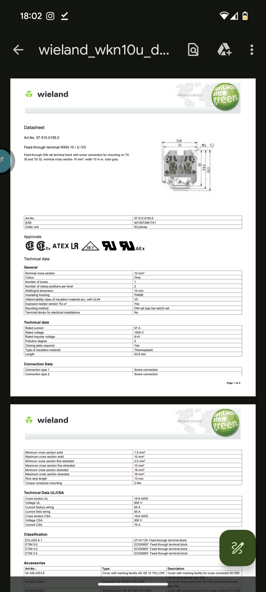

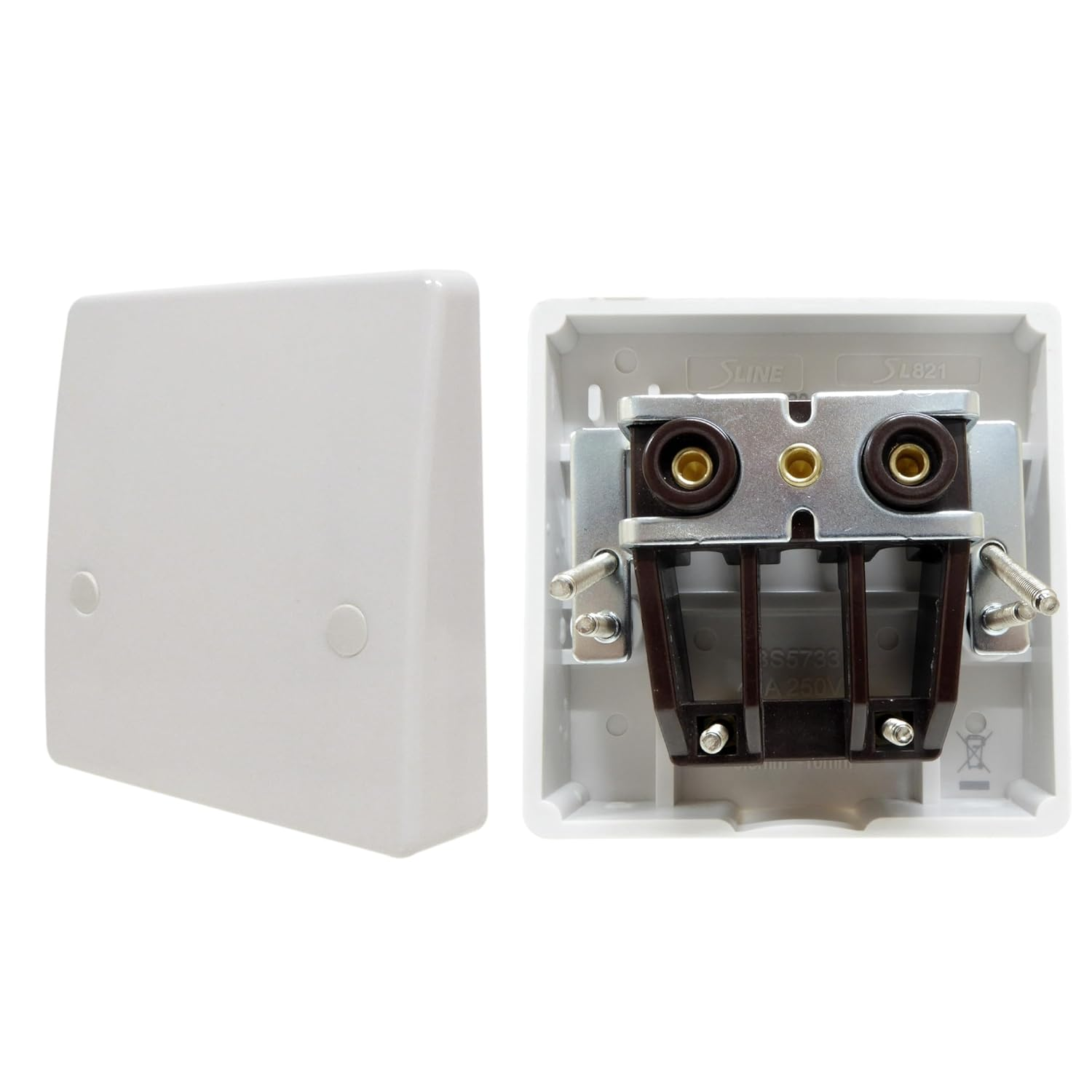

I would like to reuse a 10mm cable to provide a ring circuit in an area. The cable is currently used for an electric shower, still connected at present and is fine. When the shower is removed I intended to replace the 40A breaker with a 32A, slightly reroute the cable and add a ring to then end. I have no idea where regs might stand on this however I can see no electrical reason why it should not be ok. I imagine that rerunning the ring will be suggested but that is easier said than done. Any thoughts.

You don't need one here, but at least an accessible and labelled junction box location is good, such as a blanking plate on the old cooker outlet, etc. 10mm is too big for the usual Wagos, but you might find something of adequate rating to fit in there.

No do not do that, it is rough and not the way. you could take the 10mm2 cable into a little enclosure with a lid and a double pole isolator switch and connect it to the top, then the 2 2.5mm2 cables of the new ring to the bottom, label the enclose and then that is better that a lollypop connection. the enclosure could be fitted in a cupboard or somewhere less noticeable to the eye whilst acting as a connection box and isolating switch. Personally I don't even like that idea but better than a lolly pop connection.
Just seeing this thread now, but the awkward part will be finding a suitable way to joint 10mm^2 cable to your 2*2.5mm^2 cables.
