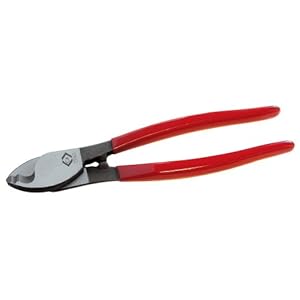

I use these
They work well on t&e and singles and saves punching yourself in the face.
