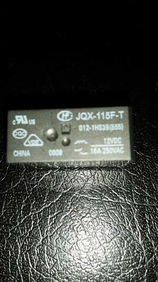

Hi,
have this relay which needs replacing but cannot seem to find the right one any where in the uk
[ElectriciansForums.net] Relay advice please[ElectriciansForums.net] Relay advice please

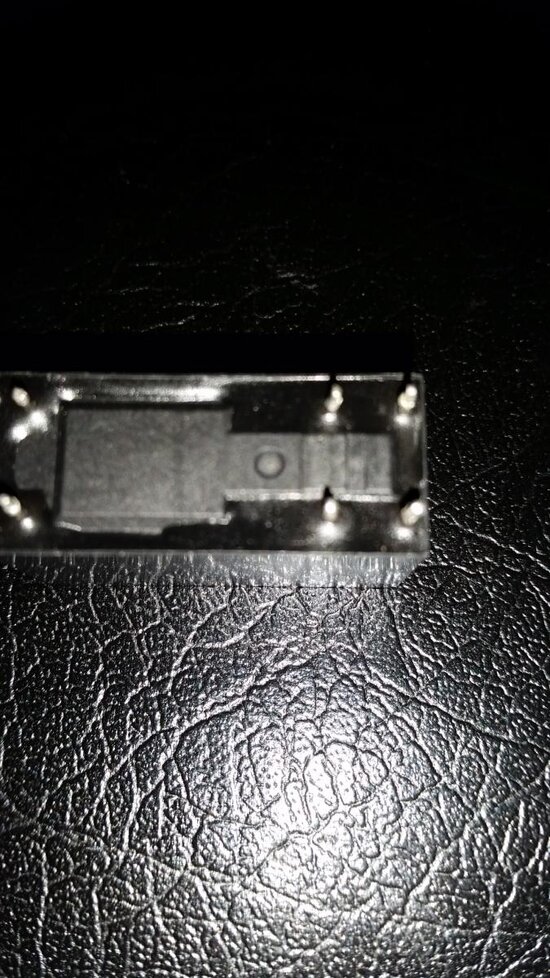

i think i may have found one at maplins but it has 8 pins on the bottom infact all the ones i do come across have 8 pins as you can see mine only has 6. does anyone know of an alternative or where i maybe able to buy one these from in the uk.
thankyou.

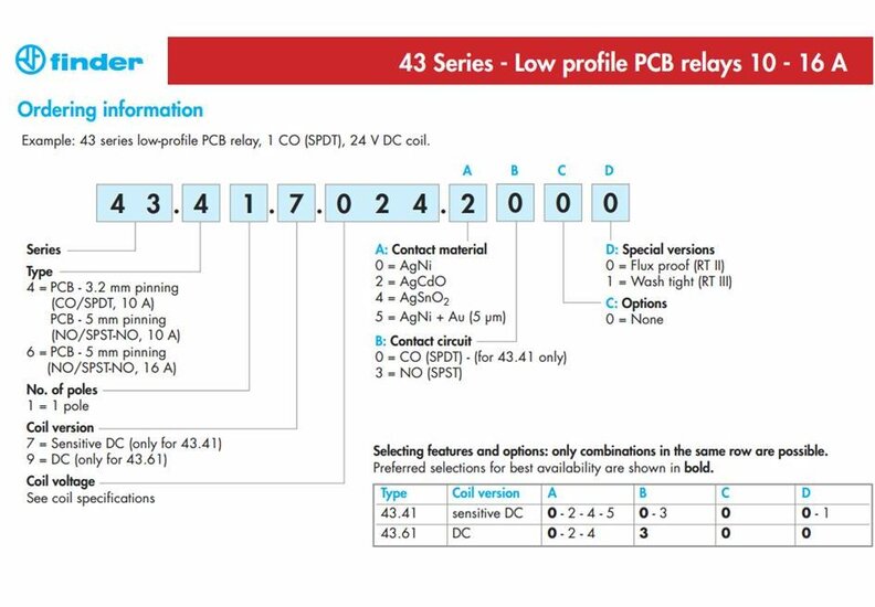

read the data sheet from the link given...it shows spdt, spst, dpdt all options, with different pin layouts
thanks i did look and it looks like i need 43.61-0300 which is the 6 pin, being a n00b as in i dont want to order the wrong part,

43.61.9.012.2300
this is the part number you need based on this information
on following the link in either mine or your post if you look just below FINDER on the right there is the manufacturers part number which is as I have said above.
so 60-478 as the Rapid order number is the correct part 6 pins, single pole, 12 V coil, NO, rated at 15 or 16A at 240V.
Your one may be normally closed but I cannot tell from the picture and this is not usual (if there is such a thing as usual).
thankyou for your help now going to order it works out at ÂŁ7.90 so not to bad :) thanks again
