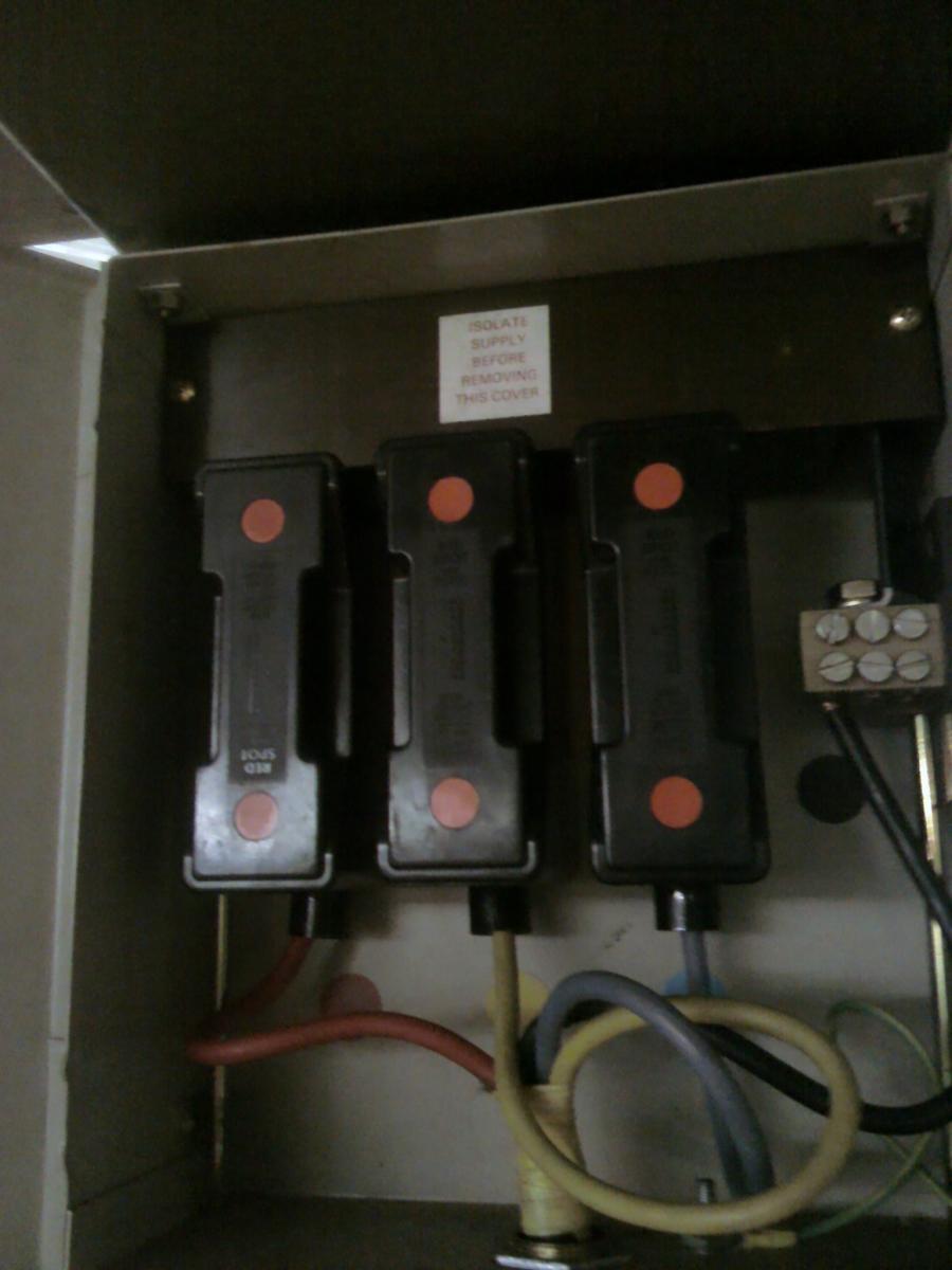

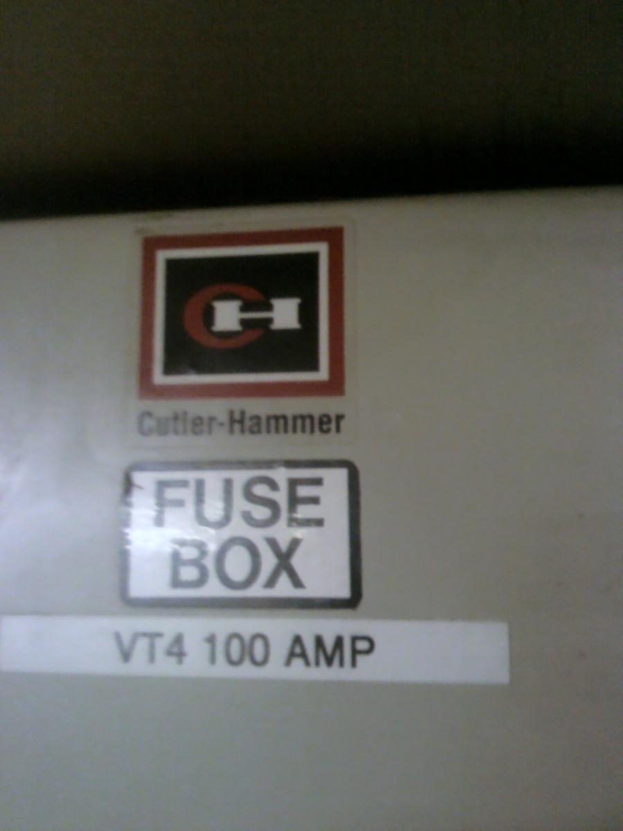

I have to remove a tap off box from a 400v overhead industrial busbar system , just need to know if there is a set procedure for the removal and installation of the tapin box
Check out manufacturers instruction if you are not sure. Fixing methods do vary between manufacturers. Make sure there is no load attached to the tap off box or you may get a flashover.
I think Mogga is correct with manufactorers instructions, who says it has no damage and its design could short out the phases when removed. I know a friend who almost lost his face working on live equipment so brings it home.
If your doughting your actions, you know the answer !
Isolate the supply to the bars. If you don’t have the instructions for the unit the last thing you want is to snag something with the bars live.
[ElectriciansForums.net] removing & reinstalling tap off box for overhead industrial busbar 400v[ElectriciansForums.net] removing & reinstalling tap off box for overhead industrial busbar 400v[ElectriciansForums.net] removing & reinstalling tap off box for overhead industrial busbar 400vsome pics of tap in box
