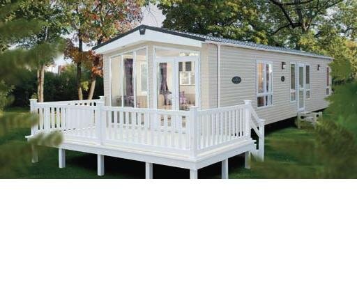

Well I suppose it depends on the size. The ones I used to build only had 2/3 bedrooms and ran off a 16A plug; 2 lighting circuits, 2 power circuits, gas boiler, gas hob. The higher end of the range came with wine coolers, ipod docking stations etc but even they don't consume that much power. Low energy lighting seemed to be an optional extra - they were built to a budget so most were fitted with 50W halogen lamps.
Park Homes | Park Homes for Sale | Static Caravans for Sale m8 check this baby out the model IKON on the home page 50 ft x 20 ft looks a bit canny lol
OK I'm totally confused now. I used to build these:
[ElectriciansForums.net] Residential Caravan homes- minimum supply
Which were fed from a 16A panel plug.
Sorry if that's "sad and outdated" but to my knowledge there's only one caravan factory around here now.
