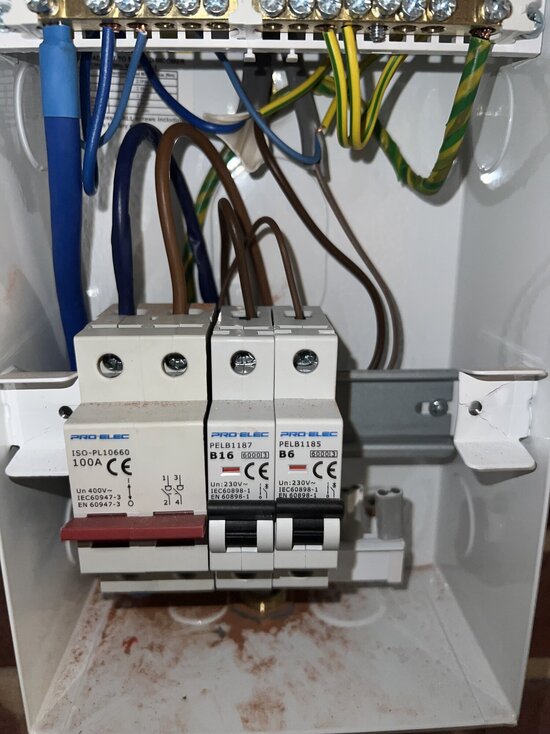

Hello everyone.
I’m looking at installing a camera on my garage. The garage has a 16A breaker for the sockets and 6A for lighting.
Am I able to use some 1mm twin and earth to wire the camera straight into the 6A with the lighting?
Thanks
Ryan

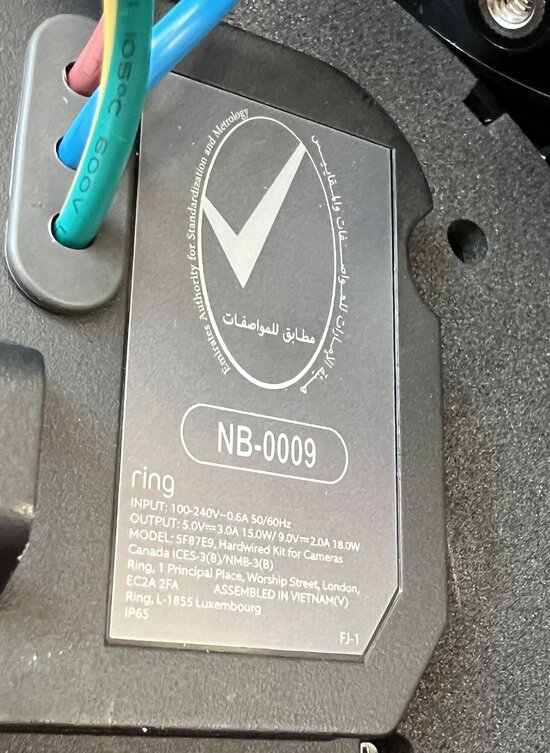

Oh really? They advertise that you can replace existing outside lights with these cameras so I thought they could simply run on the same wiring.
Is there a power supply you could recommend?
Cheers.
Edit: So I forgot to mention I’m using their “hardwired kit”. Does this have the power supply built in? I’ll add a picture of the info on the kit.
Cheers.
  • [ElectriciansForums.net] Ring Spotlight Camera Wiring
Cheers.
Cheers.
My apologies, I had assumed (wrongly) that it was a ring doorbell
The camera is suitable for direct connection to the lighting circuit.

Hopefully there's an RCD feeding the garage Cu.
