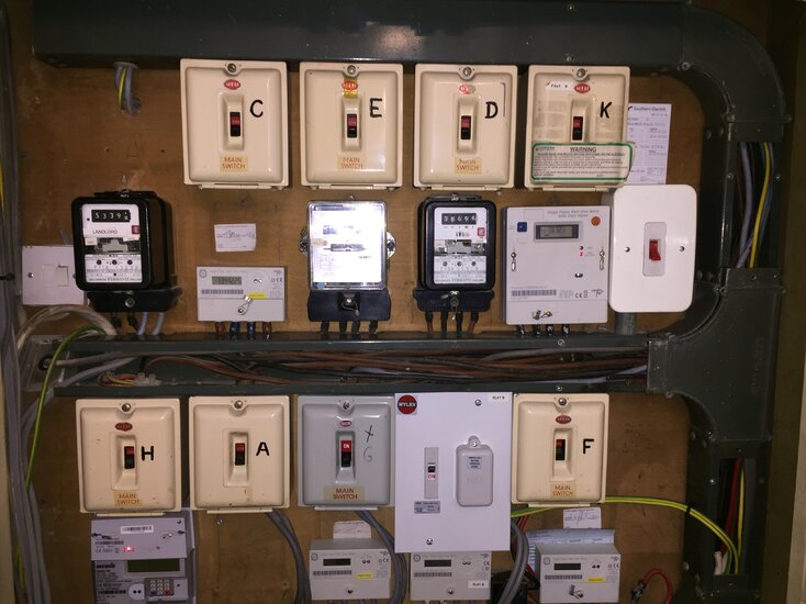

If any of you would have a minute to give your 2 pence on this I would appreciate it.
I have a Rye field board supplying 10 Meters in a old house split in to Flats, The Tail for all of these Flats are installed with VIR cable, this is also from the Rye field board to the Meter , from the meter to local Isolators, and from these to the Distribution Board within the Flat, the Installation is probable 1950's and the Installation method is trunking within the Electrical cupboard and then conduits to the Flats DB's floating for the last half meter to the Consumer unit. The Ryefield board has BS 3036 rewire-able 60amp Fuses which bring to my attention the PFC Issue I now have.
Now I'm going to codes these as C2, and recommend replacing the VIR with double insulated PVC cables between , between the Ryefield and Isolators, then an SWA to each Flat.
Even consider recommendation to the replace the Ryefield board, as the PFC is 2.9 KVA single Phase and therefore 5.8KVA Three Phase
But the question here is Who responsibility will it be to replace these Cables for the Ryefield board? I would normally say the DNO, but every time I've done a new supply and worked with the DNO's they have always refused to install the cable from a Ryefield board to the Meter, I Guess this is due to the Risk assessment and they wouldn't allow any of there Engineers to work (on or near live electrical works).
Also I would does any one Know why Ryefield boards never have an isolator?
Any thought would be welcome the Technical help line for NAPIT was of the option to excluded the Ryefield board but I don't think thats Rights.
many thanks
Kirk

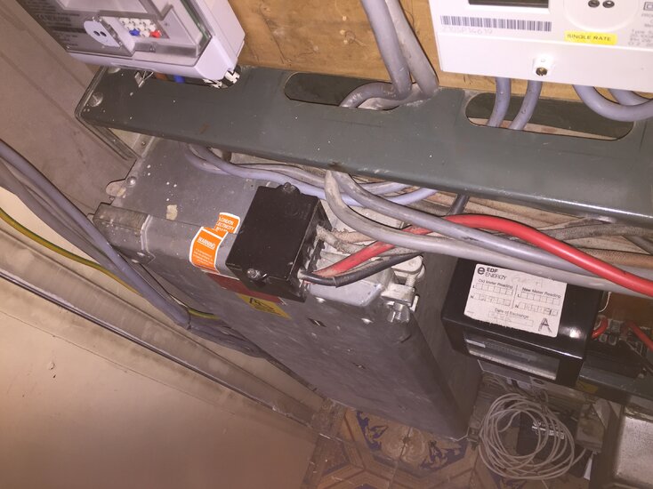

Not uncommon for a Ryefield in London to have no seals some are a right state. Have they created TN-C-S within it as many only have a single PEN bar. It is almost certainly the DNOs unit.
What does the dno cut out look like is it big old green metal Lucy head? I have come across this a couple of times also in London sw area and the dno take no responsibility after the head isolator or no isolator. From what you have said I'm not surprised it hasn't been reported by people changing metres as I've met a few (not all) who don't bat an eyelid at the cable they only check the size. I would also recommend it be updated.
Its not quite like a normal Lucy Service head as I know and have seen them with the Fuse directly above it, but it is an old metal 200 AMP service head with a swing door on it, That could be just an age thing here. so its a TN-S system, no seal or tag either on the service head, they've had about four meter's change over to smart meter's over the last couple of years.. so nice job boy's in inspecting your own installation!.
The Ryefield board is about half meter away from the service head, connect by some 3" metal trunking and single conductors, so pretty standard in its arrangement. And yes it is a west London.. Well done Rosco
I guess the question really should be, Should I Include the Ryefield board as Part of the EICR and from it as a Distribution Board to the Sub Main, I think regardless of the owner ship it is still a distributions board warts and all and covered by BS7671,
My Remit is to Inspected the Landlords supply and sub mains to the Flats, so technically and morally it falls to me.... plus I see some work in of course.
I personally wouldn't test circuits from it because you are unsure of ownership but definitely record its condition and the "assumed" means of circuit protection it contains.

The swing door on the head sounds about right just be aware that I've had the dno guys say they won't work on those heads anymore for connecting tails to isolators etc they replace the head which can take 8-10 weeks to organise, if you get the follow up work that is.
Worked on loads of them, the DNO are not always responsible. Had a situation in Northampton council block of flats,400amp in take, multi way feeding meters in trunking, cut along story short, the council inherit the ryefield boards. Especially if subbed to each floor, which would have been ran in by contractors properly.?

what I'm doing is listing the Ryefield board on my EICR as the Main DB after service head, with 13 circuits ( Sub main feeding the Flats and one Landlord supply) protected by the 3036 fuse... commenting on Warts and All regardless of ownership.
I/ the client will have to contact UK Power networks, they got to look at there Earthing connection to the Main Sub main Cable, not up to standard ... and they can assess the Ryefield at the same time... which I'm pretty sure they will disown.
