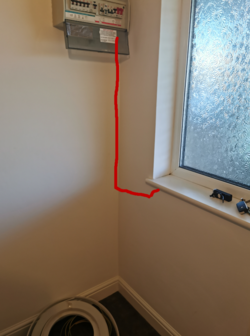

I've been told I need to upgrade the main earth bonding to 16mm.
The consumer unit is on the wall adjacent to the externally mounted incoming supply box - I basically need to run the earth wire down the corner about 1m and then across the side wall about 30cm then through and into the back of the supply box. 15cm of the horizonal run would thus be outside a safe zone.

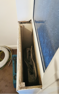

Sorry I wasn't clear.
First photo shows the proposed route.
Second shows the windowsill removed and reveals the box the electricity meter is contained in.
I'd like to bury the cable as opposed to running it surface mounted.
If (and as I wrote above, it doesn't make any sense, but regs sometimes don't make sense) the rules regarding the location of buried cables apply here then I see I have the following options:
1) Surface mount to a position where I can drill through into the back of the electric cupboard.
2) Channel out and conceal the cable running down the corner, but surface mount the section that runs across the wall until I can drill through into the electric cupboard. If I did this, I'd run the horizontal conduit just above the skirting.
3) Drill through to exterior for some/all of cable run - cosmetically I think this is the least desirable option.
4) Find a way to run the cable as illustrated in red, that IS allowed by the regs if possible? E.g. fitting a blank faceplate?

Why do you need to upgrade the main earth?
Anyway that stuff whatever it is in the walls would not comply as to safe zones by the looks of it so attaching cables of any kind I would not do. That is strange!

Either surface inside or as its been said drill outside and clip directly. Make sure the main tails are 25mm or they'll have to be upgraded as well.
"As it is clipped direct and it is apparent where it is running to I do not think you need to worry about it. The whole idea is avoiding hidden cable being damaged. This is not hidden just goes straight through the wall to the other side where it can be seen so very little chance of someone deciding to drill exactly where the cable goes through. That is if I am understanding you correctly in your description."
See this makes no sense to me.
How could there be a risk in drilling into an earth cable, that was magically NOT there when drilling into an earthed conduit?
The two are at exactly the same potential at all times.
