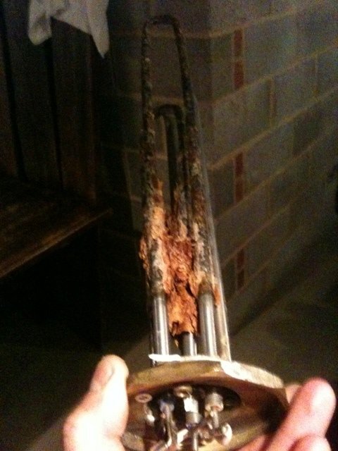

i took this out of a hot water tank that has 3 x 20kw heaters. the tank is 10 months old. wat is the cause of the scale build up and wat can he do to stop it. its in a hair salon.

Think they're designed for cold water application temperature 1°C - 40°C
It's a bit late to remove the scale once you have heated the water and clogged the cylinder with scale
They are designed to fit into the cold water supply to electric showers, washing machines , hot water cylinders or any other appliance that is prone to scale
