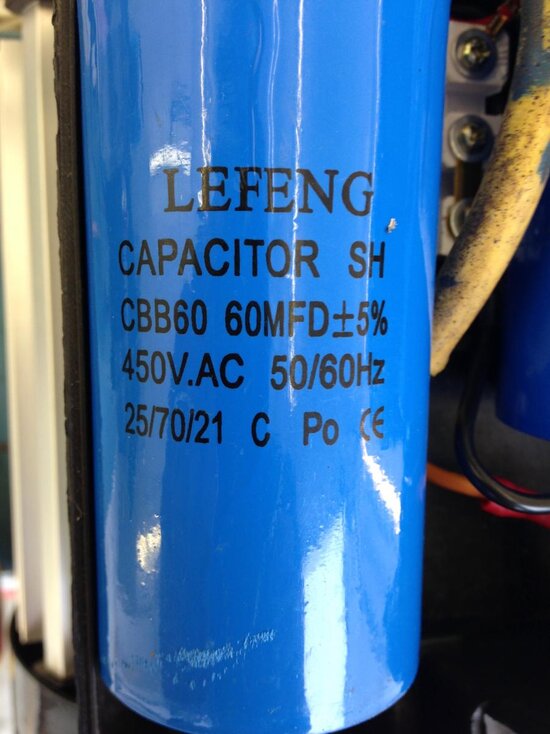

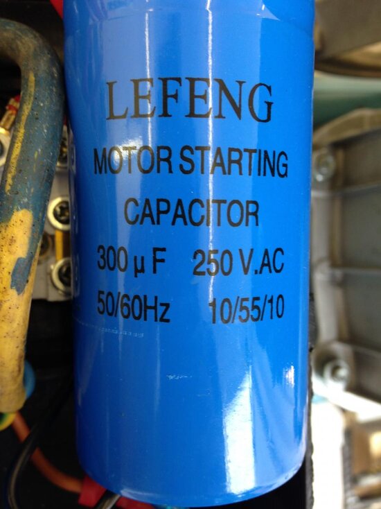

Please help. I have recently fitted a new pump, pressure switch and a 2.2kw(3HP) single phase 240v, 2 pole electric to my compressor. However I am at a loss at how to wire it. I have been trying to google it for 3 days, but am getting conflicting answers. It is a start capacitor and start run motor which runs anti clockwise. I have had it running, but when the compressor almost reaches cut off pressure the motor reset button trips. It is connected via a blue 16amp plug and a 20 amp RCD. I have attached some pics. I currently have it wired as follows: live(brown) to the reset switch and neutral (blue) to Z2/W2. Thanks for looking

Thanks for your reply Marvo. I assume it's a 2 pole as it's rated at 3000rpm. The original motor was 3 phase and I've just swapped it for a single phase. Also when under load the start capacitor gets very hot and there was a small amount of smoke coming from the reset switch.

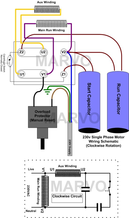

If you insist you want to carry on then after half an hour of my life I won't get back here's your schematic of how your wiring should go. I'd strongly suggest you commission this or any other motor with a clamp meter to ensure you don't exceed the maximum run current stamped on the plate of the motor otherwise you're likely to destroy motors like they're going out of fashion.
[ElectriciansForums.net] Single phase 240v motor wiring
Please note the Z1 and Z2 denote the centrifugal switch and this setup will give you clockwise rotation if your looking at the motor front on.
Thanks for that Marvo. The motor now runs perfectly at full speed. However it now runs clockwise and I need it to run the other way. Any advice is much appreciated. Thank you.
Okay, when I made the drawing I was being lazy and hoping you weren't going to ask this. The drawing I gave you was electrically correct for clockwise rotation but the way I'd laid it out made it topographically difficult to easily show the way you change the direction so I've amended it slightly. Just check that the capacitor wires and overload wires conform to the exact locations they're in as shown on the amended drawing above.
If you need to change the rotation direction on the internal wiring, ie not using an external reversing starter, then you basically remove both the brass links and reinstall them facing the other direction as show below.
I've added a circuit drawing with the legs of the winding labeled so you can see the difference between the two wiring schemes electrically. Also please note that the centrifugal switch I've shown on the new drawings is actually built into the motor so you won't see it as an external component.
