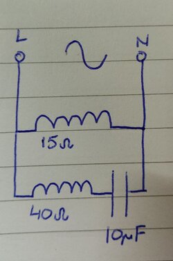

I am trying to fix a single phase ac motor but need some help. When powered on and put off load, motor humms but doesnt rotate, its sort of magnetically locked because even trying to rotate by hand it very hard to turn (motor was removed from housing and therefore I have stator and rotor exposed)
When switched off, rotor turns freely and smoothly by hand, therefore bearings are not an issue.
Motor is a capacitor run. Checked capacitor and both windings, all looks fine (see image attached). Coils ohmage measured was 15 and 40 ohms and capacitor reads 10microF OK.
Can someone please help what could be the problem? Thanks!

That diagram shows a permanent split capacitor motor, the most common cause of what you are describing would be a failed capacitor.
Hi westward10, capacitor checked with multimeter on Farads setting - reading = 10microFarads as shown on casing. Aslo charged it with 240V and shorted pinouts to check if it is holding charge, also OK as pinouts sparked. Any other ideas?
If the bearings, windings and capacitor are ok that doesn't leave much else! If the rotor locks when power is supplied only one of the windings has power or they are both in phase due to a faulty capacitor. I would ignore the capacitor test results and try a substitute capacitor.

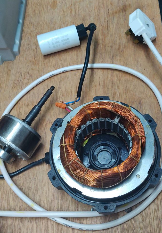

Hi, no there is no centrifugal switch, see new image attached.

Hi, yes this was working fine. There are 4 wires coming out of the motor, 2 for capacitor and 2 for L+N, as shown in schematic. Thanks for your help. Any ideas?

Thanks for the replies. Actually i noticed that the rotor does turn very very slowly while humming. I did not notice this because I am switching it off immediately since its heating up a lot quite easily and i m trying to avoid the damage.
I also suspect the capacitor is breaking down when subjected to full working voltage and would second Freddo's suggestion to test by substitution. If the motor is uncoupled from what it drives, and you can do so safely, power the main winding only (with the capacitor disconnected) and give the shaft a shove in the normal direction. With no mechanical load it should accelerate to normal running speed, although will lack torque. If it then runs quietly without excessive current or heat, the main winding at least is probably OK.
Has there been any sign of overheating or overcurrent that would point to shorted turns in the winding?
And a quick test to eliminate sillies: if you haven't done so, measure the resistance between the ends of the windings not connected together and confirm it's 55Ω.
Image of disassembled motor

Hi, I did try to power it with capacitor removed. Same thing happens (hum and locked). Yes both stator windings and rotor heat up very quickly, after 10seconds ON its very hot
Yes I had already checked resistance of both windings, 55ohms OK

Unfortunately then I suspect the 15Ω winding has shorted turns if it heats that quickly. The shorted section behaves like a shorted secondary of a transformer, causing heavy current to flow in the remaning intact turns. You might be able to see some sections of the winding discoloured. It probably isn't economically viable to repair.
If that is the case, does it make sense that rotor also heats up a lot? I can t see why rotor will also heat if windings in stator are shorted. What do you think?
Heavy currents may be circulating through the rotor cage winding due to the distorted pole pattern around the stator resulting from the short. A substantial power current (in-phase) is flowing instead of just the magnetising current (in quadrature) which can also be the cause of the braking effect.
