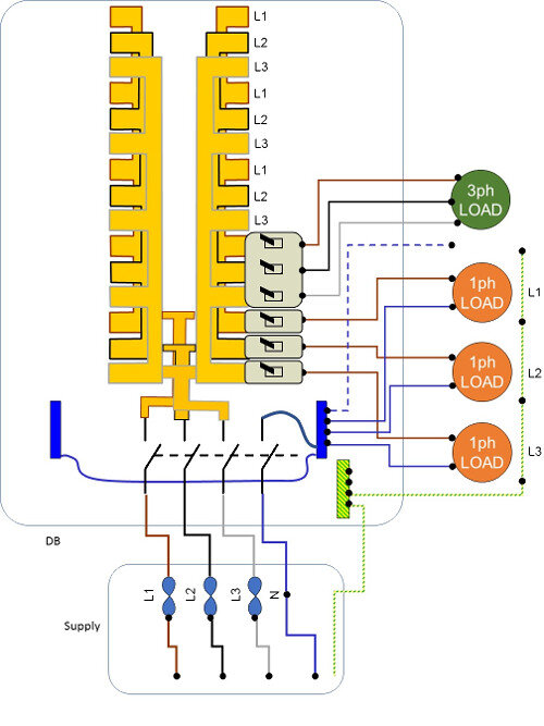

been helping out at a local industrial unit today and something got me thinking. There was an old 3 phase isolation switch that was still live from 3 phase DB2 however there was no load from the switch. The owner wants some power sockets and lighting on the upstairs mezzanine area so the 3 phases/neutral and earth from that isolating switch was pulled and re-routed up to the mezzanine and made safe ready for some sockets on another day.
I can't seem to work out how they will wire single phase sockets with a 3 phase supply.
What's the normal way of practice? Terminate all 3 phases into a 3 phase box and then take a feed for sockets? A feed for some lighting?
All 3 phases are fed from the same 3 phase mcb
Yes, mixed single phase loads such as sockets and light can be supplied from a 3-phase DB. All 3 phases should be terminated into a main triple pole MCB. From there the phases can supply single phase RCD's for socket circuits and single pole MCB's for lighting circuits etc. The single phase loads should be 'ballanced' as well as possible to prevent overloading any of the phases.
So from 3 phase db2 the 3 phases would then terminate into another distribution board and supply single loads from there? What would this distribution board be? A 3 phase board? Not sure I understand how the phases would be terminated into a board and then be used as single phases

I hope I'm understanding what your question is but I'm worried I might not be. Here's a 3-phase DB with mixed single phase final circuits as well as a 3-phase final circuit on the right hand side, you can kinda see the wiring in the video. The 3 incoming phases would go into the t/pole MCB. ;
Ok I can see that but how do the single phases actually get the power? Is that 3 phase supply on a din rail that all the single phase and 3 phase mcb's operate from?
What's the options if another board is not possible? At the moment the phases/neutral and earth are just wound up in a corner on the mezzanine floor. I didn't get the impression another board was gonna be used
So in a three phase DB, you have the main isolator (typically 4 pole I believe), which feeds three sets of bus bars. Which when you look at the board provide an outlet position for phase 1, 2, 3, 1, 2, 3, 1, 2, 3 etc.
For a three phase circuit you bang a 3 phase protective device in which connects to all three phases. For a single phase circuit, you use a single phase protective device which connects to the phase provided in that slot.

This is a diagrammatic representation of single and three phase loads being supplied from a three phase board.
