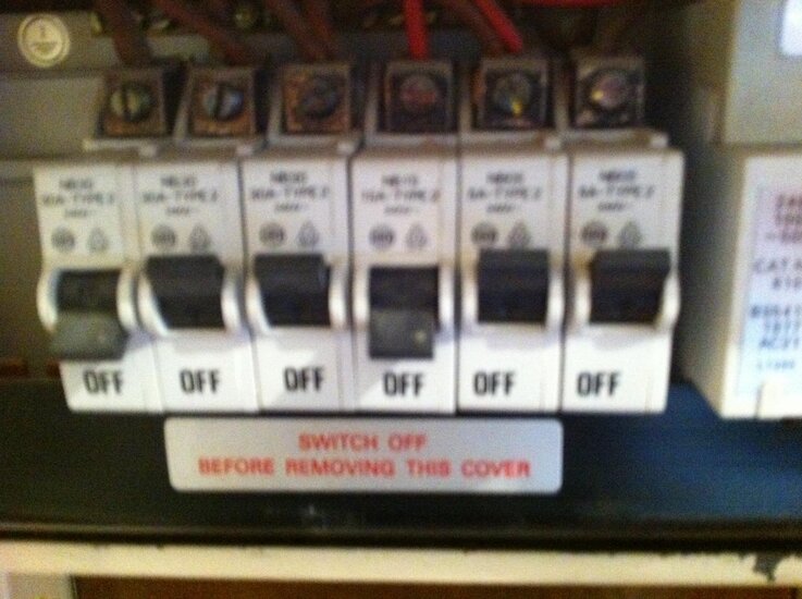

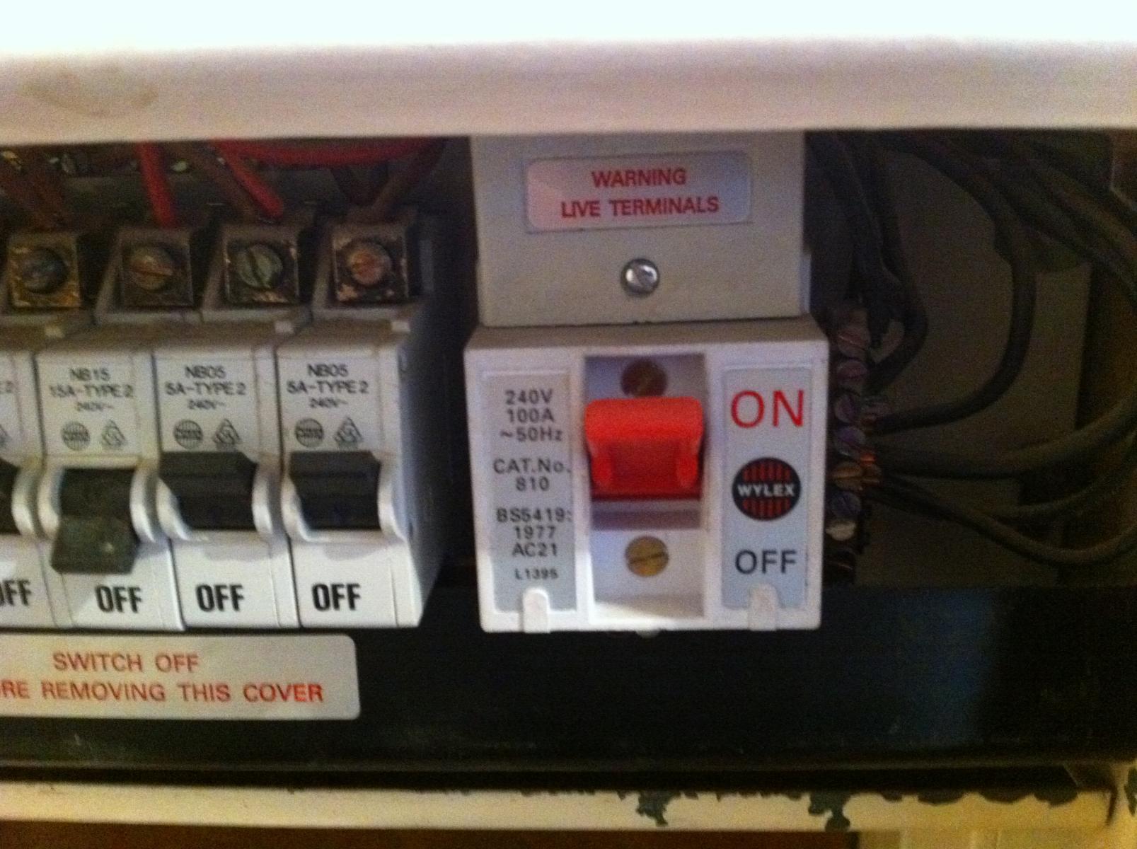

Here is the original CU
[ElectriciansForums.net] Skeleton CU replacenemt.  Earthing question TT or TNS

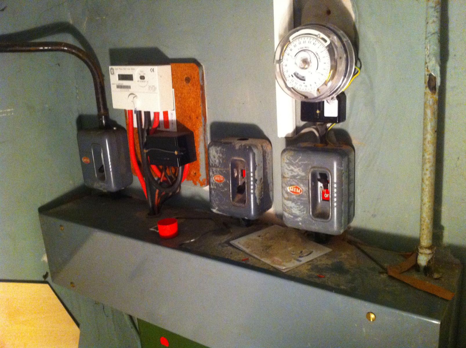

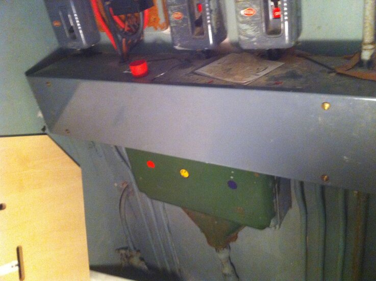

Hi all thanks for all your help.
Here are some other pictures. The first 2 are of the kit under the stairs in the ground floor that supplies all the flats.

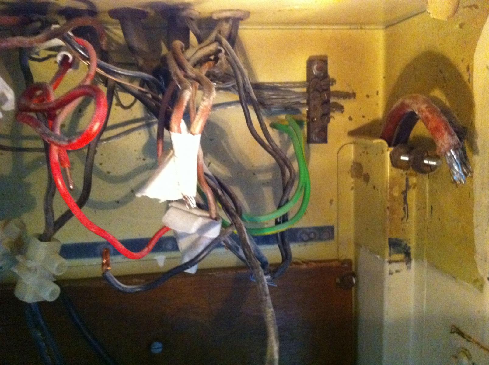

The last shows the inside of the mantel showing the mess that was there when i removed the CU also it shows the earth block bolted to the back with the old earth conductors etc

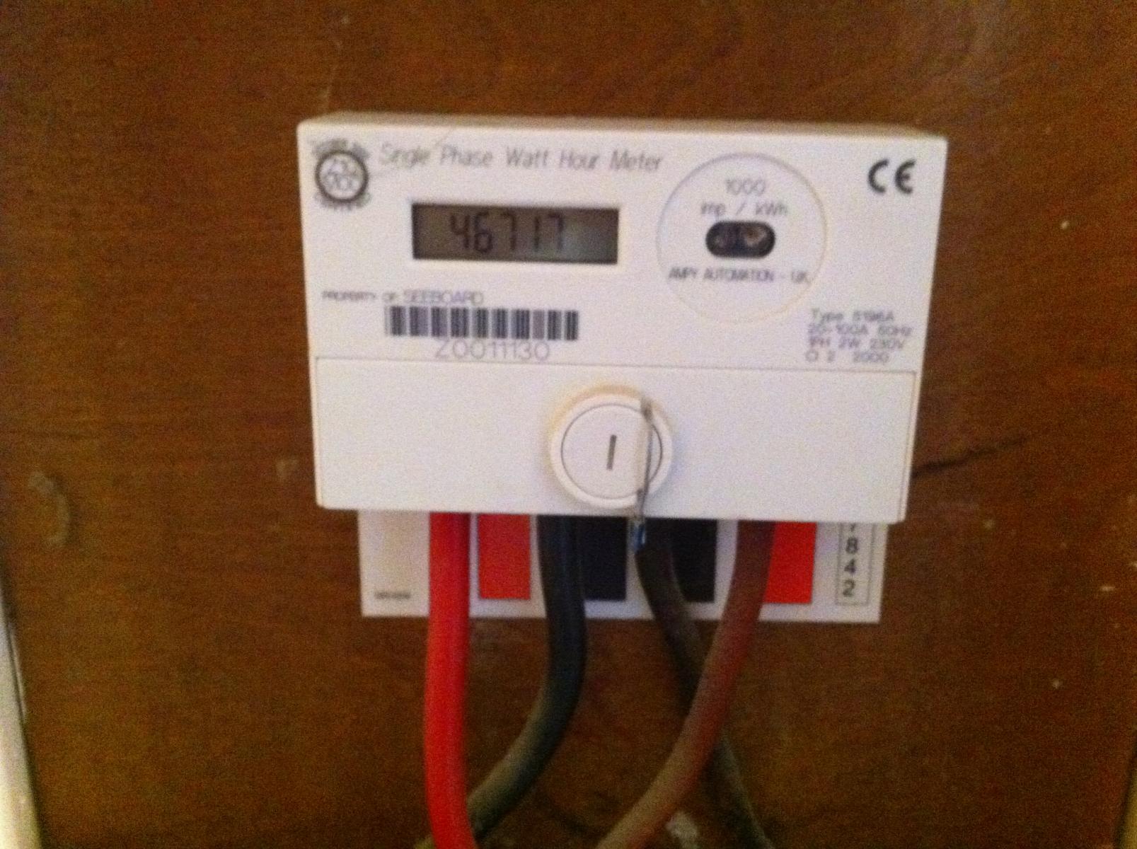

Dont have any pictures of the suppliers fuse etc but that and another box sits in the bottom of the metal box under the meter shown here. I cant see any incoming cable just the red and black tail coming from the main fuse.

Well your certainly right about the wiring being a complete mess in that Mantel box!! It really does need a complete rewire this flat, it's full of braided VIR cables, that don't look to be in very good nick. So not just a CU change me thinks!!! Can't quite make it out but are those rubber grommets coming into the top of the mantel box?? If it is, then you will need to pull a separate CPC at least to the first conduit box, but further investigation and testing will need to be undertaken to check the continuity of the conduit installation...
Not quite sure why you have 2 supply meters, one at the main intake and another at the mantel box??
Can't see any earthing cable at the main cut-out, but that doesn't mean there isn't one. Take the trunking cover off and check what you have coming from/out of that DNO cut-out. The earthing conductor may well be taken from the top of the cast iron service/cut-out box. It could also be a converted TNC-S, ...but all will be revealed after removing the trunking cover....
As E54 Says, that trunking lids gota come off, and picture 3 does show a mess of VIR's Not sure how far you planed to take this job, but your looking at a rewire! then virs may be sound at the CU area but I bet they break apart at the light fittings... trip trip trip :)

After sorting through the mess the cable condition were better than I expected. IR was fine >299 megohms on all circuit. But i am rewiring 4 of the 6 circuits including the lights as there was no CPC ;). A lot more work that I was originally expecting but thats how it goes sometimes
