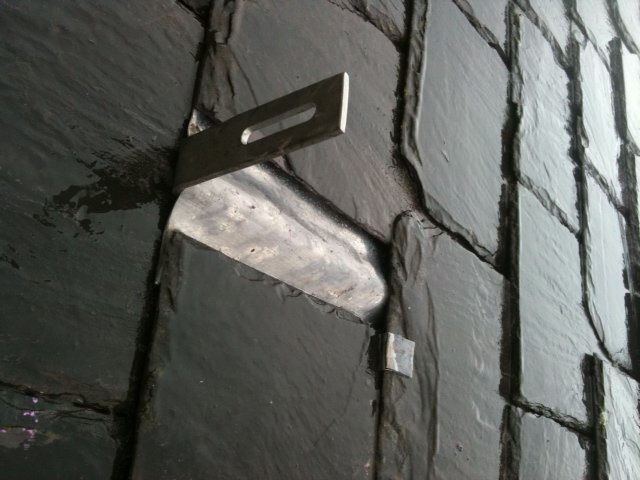

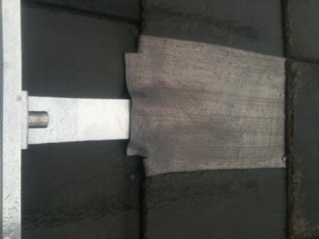

We are doing a quote for a slate roof and know from previous threads that there is the difference of opinion about drilling vs removal of the slate tile in order to secure the roof fixings. We have had some training with a well known company and they advocate removal of the tile but instead of using lead flashing they use something called Ubiflex.
Has anyone come across this or know of another cost-effective way of tackling slate roofs without compromising the integrity of the roof? We would prefer not to drill.

We've used lead and Ubiflex on slate roofs and the Ubiflex seems fine - it's just a bit thicker which makes it a little more difficult to slide under the slates. I've tried to attach a couple of pics of the two different ways we've done the slate hooks (only have pics with lead but the Ubiflex certainly worked on the second method)
