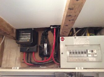

I am a builder who is renovating a rural property. A smart meter is due to be installed. It would IMHO be a good idea to get a rec switch installed. What can I expect the meter installers to do ? There is just about enough space for a slimline rec switch / isolator. to the right of the service fuse ?? I am wondering if installing a small board to the left of the current meter and get the new meter fitted there,
Will the installers just connect to the rec switch and leave the supply to the CU to someone else.
I guess the henley block was when the current CU was installedand the meter tails were not long enough ?

last meter change I came across was where the meter monkey had sheared off the slot in one of the terminal screws in the new meter. that's the reason they want twin screw teminals. ?.
Similar happened to me a while back - the very tip of my 4mm hex terminal driver decided to shear off and get stuck inside the terminal screw on a recessed mounting of a brand new £700 3ph adjustable ELCB. I may have sworn somewhat. (I did, eventually, get it out after half a day's peeing about).
