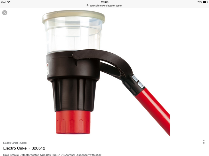

Doing an eicr at a HMO property today and was asked to test/certificate for the smoke detectors which are aico mains powered interlinked alarms, i dont know of any certificates for domestic smoke alarms. Its a grade D ld2 system, all test putton worked and all sounders activated when one unit pressed but on what certificate do i put this? Circuit was on own breaker all tests good. Any advice welcomed..
[ElectriciansForums.net] Smoke alarm periodic certificateNot sure what cert you would put this on, but we did some EICR for a housing association, and although it's not part of an EICR, they asked to test the mains smoke alarms using an aerosol activator like above.

Do those devices actually test heat alarms too, or do you need to set fire to the kitchen?
I don't think they work on heat alarms. (The smoke aerosols, not sure if there's something for heat)
The client just wanted a note making on the EICR stating whether the alarms worked or not, they loaned us those activation poles.

You can get the same sort of tester for heat alarms. Same design but instead of arosole
It has a battery and a little fan heater that blows heat at the detector
