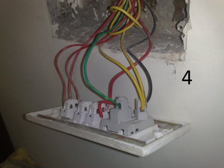

I didn't get a picture so I found one online similar, so this is ok then?

I don’t know what that last picture is, but it doesn’t look ok.
when the plate is screwed back, I don’t see any metallic connection from the back box, through the screws to plate, and then to the cpc. There’s no metal around the fixing holes of the plate.
Some old boys did just wrap the wire round a fixing screw, but the right way would be to drill and tap a hole, fit an M4 earthing stud.
I don't think that is showing a UK socket anyway.

I think the grey part could be a socket?? But on that particular plate shown, yes, the back box does need an Earth as there’s no connection from the terminal through to the screws.
I would think all UK sockets have metal around the screw holes, whereas light switches don’t. (No earth terminal on the plate, must use the back box)

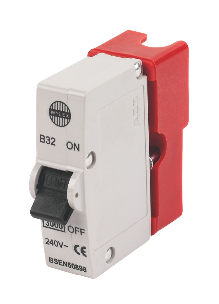

Again, this illustrates why I don't like the rewirable fuses, they are often rewired incorrectly. Short of a CU change you can get this sort of thing:
They won't solve the lack of RCD protection risk, but they are massively easier for most folk to deal with if something trips and less risk of "oh stuff this bit of wire in, it will be OK" happening.

@littlespark Thanks for the info regarding drilling a hole and fitting a
an M4 earthing stud. Like I said above the picture is a copy online that resembles the socket I saw in his house that day. The only difference is that the wiring to it has been renewed but no earth attached to the galvanised back box.
