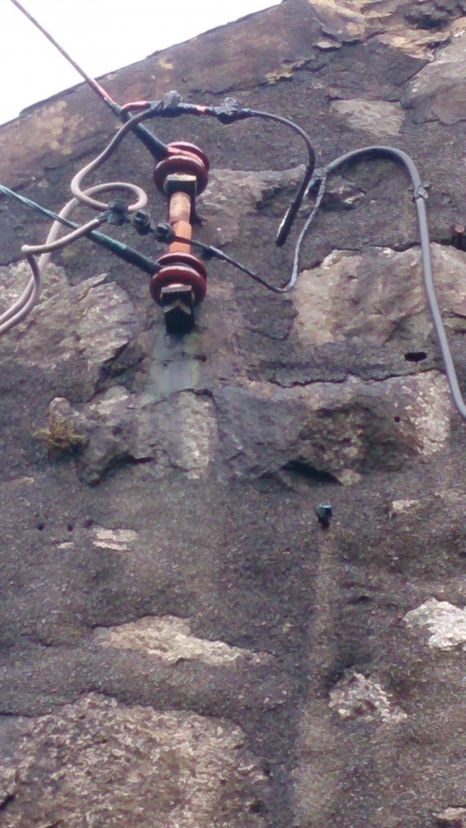

Stone built (140 ish years old) end of terrace house with an old two wire onto ceramic doughnuts overhead supply. The DNO inspector came out to look at it and they're replacing everything from the head to the pole FOC.
What caused such a remarkable event? I'm sure we all know how they like to charge the customer. Well in spite it being required due to the incomer's condition (IMHO) it's not being replaced for electrical reasons. It's being replaced because the guy doing the pointing wants to have scaffolding up on that side of the house.
So if you need new overheads or incomers, ring the DNO and explain that scaffolding needs to go up.

If the supply is as old as you say, the singles will be paper insulated with a jute outer braid, this braid is impregnated with red lead. Over time they crack and the jute rots, so not surprising they’re changing them. I’ll bet the new job doesn’t look as good as the old one.

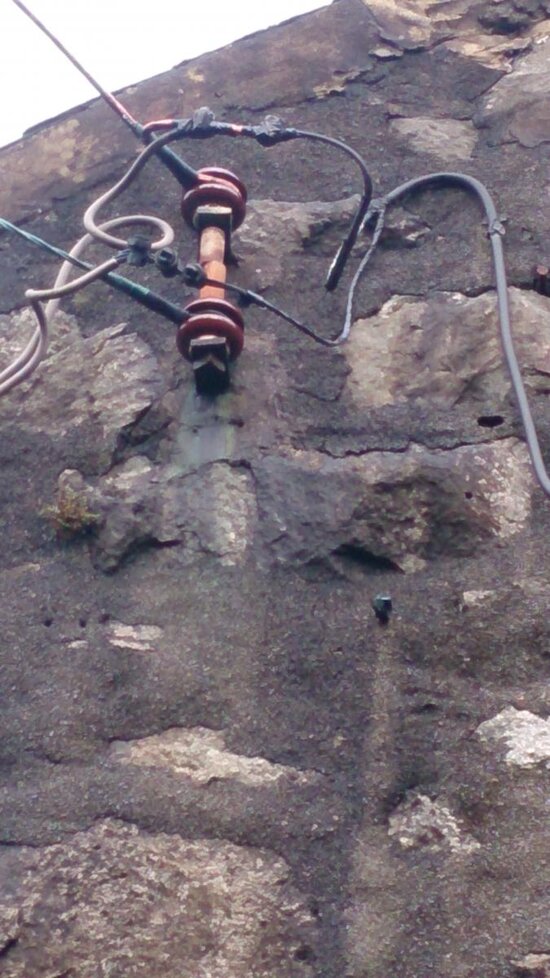

It's not the neatest work so it's hard to imagine how it'll be worse when they've finished.
True, it’s not good.
E54 will go wappy when he sees that concentric breakout. Damp will track down the neutral with it not being sealed correctly. As for the line taps, the less said the better.
PS that is the cable I mentioned, it’s old.
The core of the concentric is bare for about three inches before the curve, you just can't see it from that angle. Ordinary PVC tape on it which I doubt provides much in the way of insulation.
