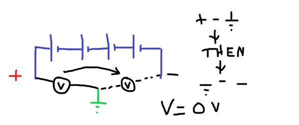

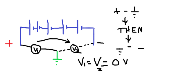

Sorry - study the 3rd and 4th images not the 1st and 2nd which I am unable delete because of the daft 20 minutes rule.

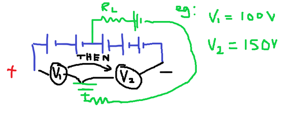

My diagrams were an attempt to explain how voltage readings (V1 or V2) can be produced which are other than zero if there is an insulation fault on a panel(s) and their wiring to surrounding 'stuff' which is in turn 'connected' to earth.
I suppose - don't know for certain - that the way the ABB measures IR is to measure V1 and the current I1 which flows, and then V2 and the current that flows I2, and then its computer calculates V1/I1 and V2/I2 to estimate the leakage resistance, and it displays the lower value of the two.
