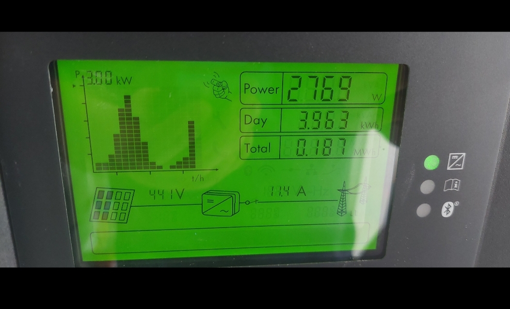

There are 2 inverters feeding into a dorman smith C16 rcbo , every time I visit this site (communal area power) it has tripped.
it switches on first time and never trips when im on site (though there is cloud cover today).
all the correct DC and AC isolators are present the inverters are a:
Shenzen JFY-TECH JSI-2500TL max power 2000 W 13 amp max current
SUNNY BOY SB 5000TL-21 max power 4600 VA 13 amp max current

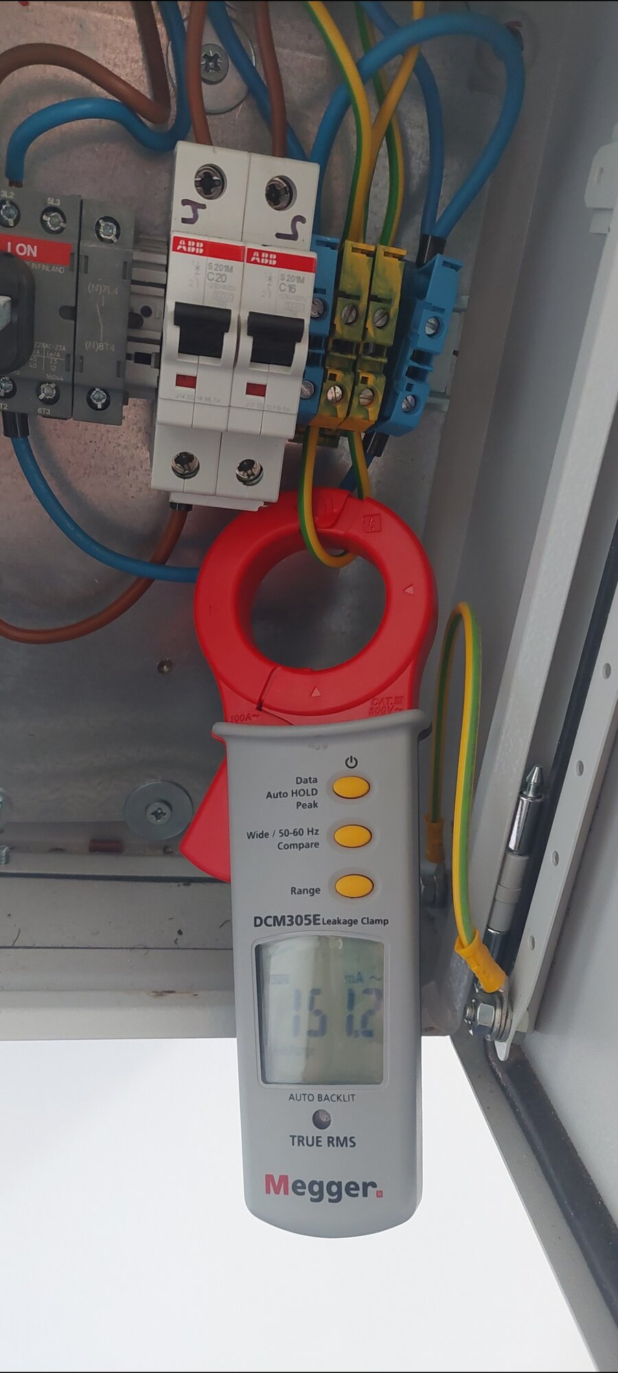

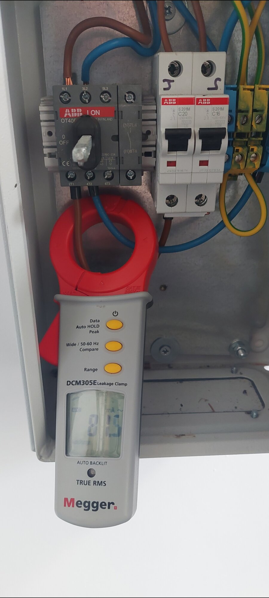

I have been back to this property today and once again found it tripped, the sma inverter appears to leak a great deal to cpc.
As the wiring is surface/tray and run in 4 or 6 mm twin and earth I propose to change to a C25 mcb and I'm considering a 100ma rcd double pole in it's own enclosure.
I seem to remember that rcbo should not feed an inverter unless it's double pole, can anyone confirm this?

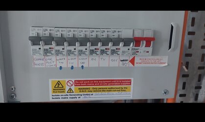

Why is RCD protection required and is there an RCD at both ends?
As you've suggested a 100mA RCBO I assume the RCD is for fault protection only and not additional protection?
I can't see that 25A overcurrent protection is appropriate either if the total load is 28A, surely that would need 32A protection?
I think your right an a 32 amp mcb will be required , its a TN system with a ZS at the inverter isolator of 0.22 ohms . So fault protection is via the MCB and 100ma cant be additional protection in the traditional sense.

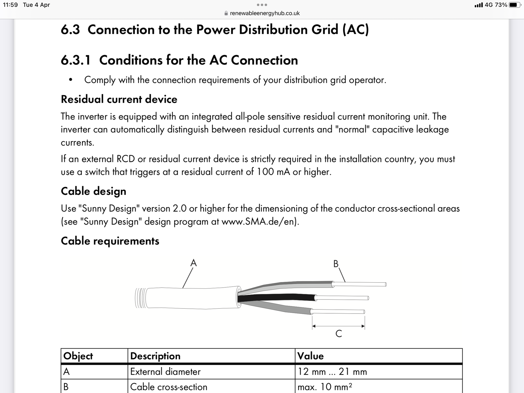

i now have the installation manual and it appears to monitor the leakage current internally.

Just because there is protection in the inverter it doesn't necessarily mean you don't need to install any.
A solar PV circuit is different to most other circuits we normally work on. Most circuits connect to one source of supply at one end of the circuit. With solar PV the circuit is linking two sources of supply together, so an RCD installed at one end of the circuit may not achieve anything as the when it trips the circuit could remain live due to the other source of supply still being connected.

Could it be the case that the clamp meter readings are in fact measuring the total leakage of circuits upstream that are using the inverters output rather than the inverter itself leaking current to earth?
Have you tried readings with no load (from grid or PV) other than the supply to the inverters and the DC isolator(s) turned off?
