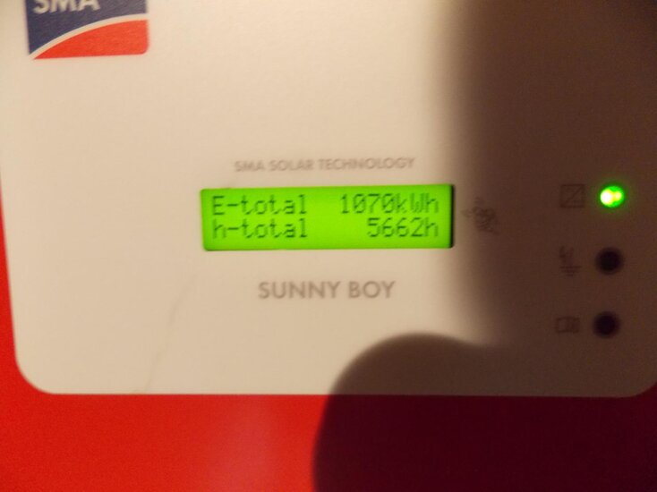

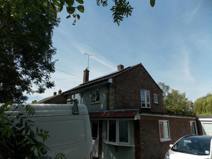

I was asked to look at a poorly performing 4KWp system in Essex last week. It was in installed in January 2013 and has generated 1700kWhr, the mcs cert says it should generate 3008kWh's. The installation company although mcs registered is refusing to go and look at it because they have relocated to Bedford.

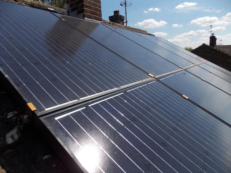

For some reason the system comprises:
1 x sunny boy + 6 x Scheuten P6-60i30 250w on a heavily shaded south east facing roof.
1 x solaredge se3000 + 10 x Scheuten P6-60i30 250w shaded north west facing roof
Why would you do that?

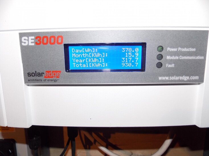

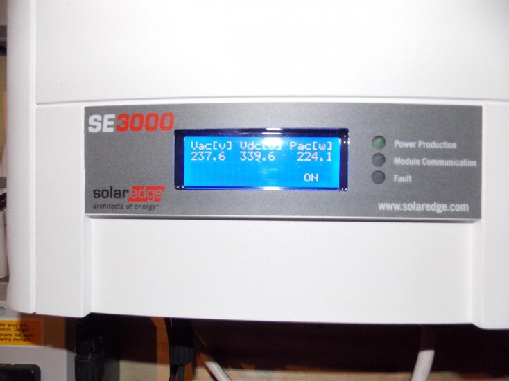

I've not installed a solaredge system before but from what I had read on here I was under the impression that it shows up the number of attached optimisers. This system doesn't show any, could it have been installed as a string inverter?

Have you re-calculated the predicted energy figures? Hard to see that could ever be a 3000kWh/yr system given the split panels, trees, chimneys and TV aerial although you never get the full picture from photos.
Hi Ted, Yes I have:
The sunnyboy + 6 modules 775KWh/year. Pretty close to what it should be.
The solaredge + 10 modules 987KWh/year. Something is amiss with the solaredge part of the system.
I'm going back on Wednesday with the solaredge mi's.

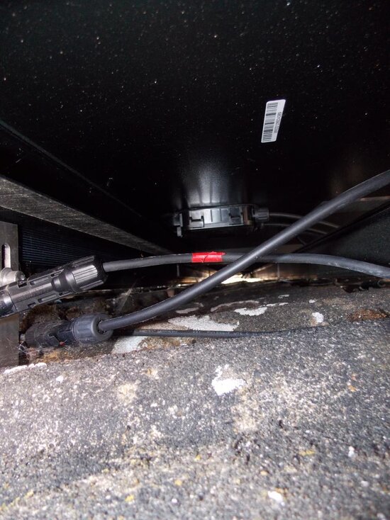

Suggest you power down the system. Test the MC4s connecting into the bottom of the inverter.
You should get 10vDC as each optimiser is designed to produce 1v when there's no inverter and AC supply.
If you get 10vDC, that means that the panels and optimisers are working fine.
Connect it to the internet and call solaredge if you have never done one, they will check that it is communicating and can reset it there end to save you trying if your unsure.
I've always found them very helpful
