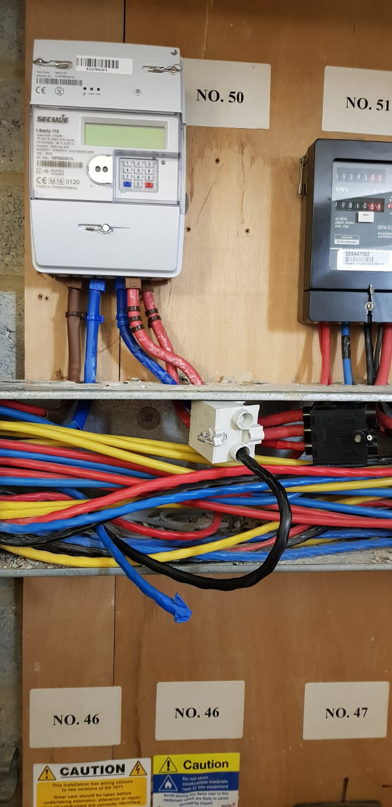

We’ve been having a long running issue with our economy 7 not kicking in at night, which means we have no heating from our storage heaters or hot water (luckily the boost still works).
Our electricity supplier said that getting a smart meter would fix the issue- which we had installed last week - but it’s still not working.
I’m pretty sure the heaters and boiler work as someone from the housing association came to have a look and managed to switch the economy 7 on for a while before it went off again.
We are based in East London- any advice or recommendations most appreciated.

Can you check the consumer unit that the storage heaters are fed from? The switches on the circuit breakers should be up to be on.
It may be separate from the main one or part of the same. A photograph showing the breakers will help.
Also a photograph of all the supply equipment... meter, incoming cable, Timeclock if there is one...

I found the comsumer unit switches (photo attached) and turned out that the switches were set to off. I thought that would fix it, but our storage heaters and boiler didn’t come on in the night. Interestingly, the storage heater in the communal stairwell did come on though.

That board is marked as the landlords supply so it shouldn’t be going through your meter. But that will be why the communal areas have come on.
Not your responsibility, but the metal trunking there should have a lid on it, and something done about the holes. The meter tails are pressing against bare metal... just be a matter of time before it wears through and there’s a big problem.

Here’s the unit in my property - all on.
I couldn’t find a time switch anywhere. The smart meter is showing two rates.

Well, we ended up getting an electrician around to check it all out and he found that the E7 cable hadn’t been connected to the smart meter at all. See the photos attached - it’s the blue wire that feeds the E7 consumer unit.
The guys who fitted the smart meter came back and finally hooked it up to the meter, no apology or explanation. They said they had assumed that blue was neutral.
However, now the E7 electric is constantly on (storage heaters and immersion). Better than having nothing but we still have to managed it manually.
To top it off, this morning our electricity flickered - I’m hoping this wasn’t just us and was a general issue.

The electrician removed the cover, it’s back on now.
I’m still not convinced the smart meter has been wired correctly, but at least we’ve got heating now.
