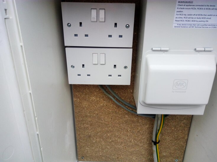

This is a construction site supply someone has put in at a mates new build site, I think there is a non compliance with the regs, see if you all agree or am I being picky?

Good job you lot don't come to me for advice, I misread the regs, was looking at sockets in excess of 16amp and these are clearly sockets rated at 13amps. Numpty!:)
plastic sockets with bob the builder around? that's a mistake. and the DB should be fitted with 3036 fuses so he can substitute nails.
They are only rated to 20amps, even though a total load of 26 amps is quite possible.
If they are rated to 20 amps then I was correct!? Look at reg 704.511.1 states that all sockets with a rated current equal to or greater than 16amp on a construction site supply shall be compliant with BS EN 60309-2

Should a temp supply have these or as previously stated am I being picky, would be good to see a builder trying to plug a 13amp plug into one of these!?:)
