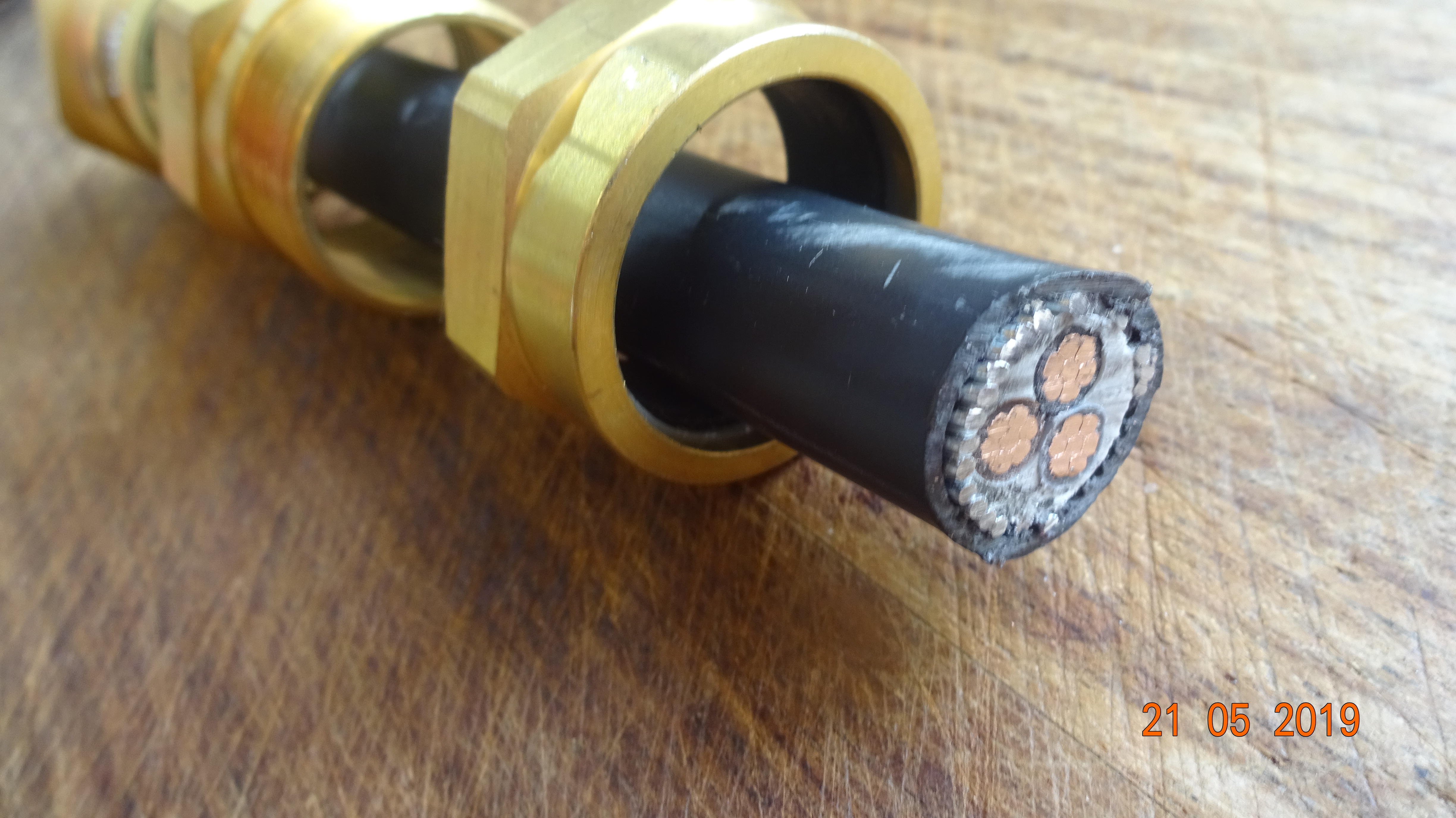

I have just laid a 10mm 3 core SWA cable in a trench under the patio from the house to a detached garage 8.5m away. (cable run will be around 18m to 20m).
There won’t be much load in the garage other than lighting, sockets and an electrically operated door and possibly a router but I am making provision for a 7.2Kw Electric Vehicle Charging point, which will be a further 10m run to far corner of the garage from the garage consumer unit. I may also install more Solar panels on the garage so the supply to the garage may also at some point be a feed to the house. Battery Storage is also a consideration. There is no water feed or metal parts to the structure. Single brick construction, wooden roof beams and tiles.

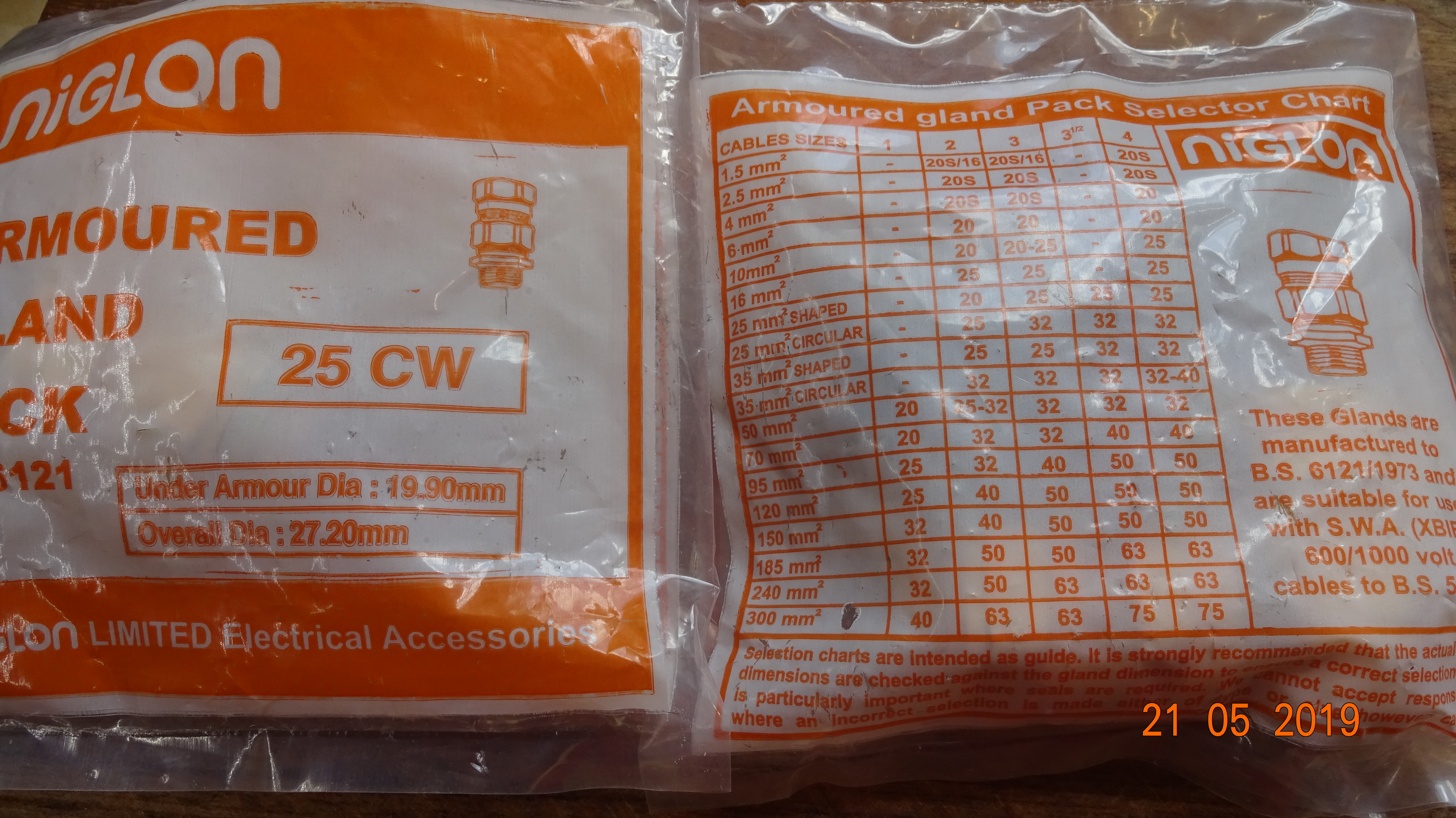

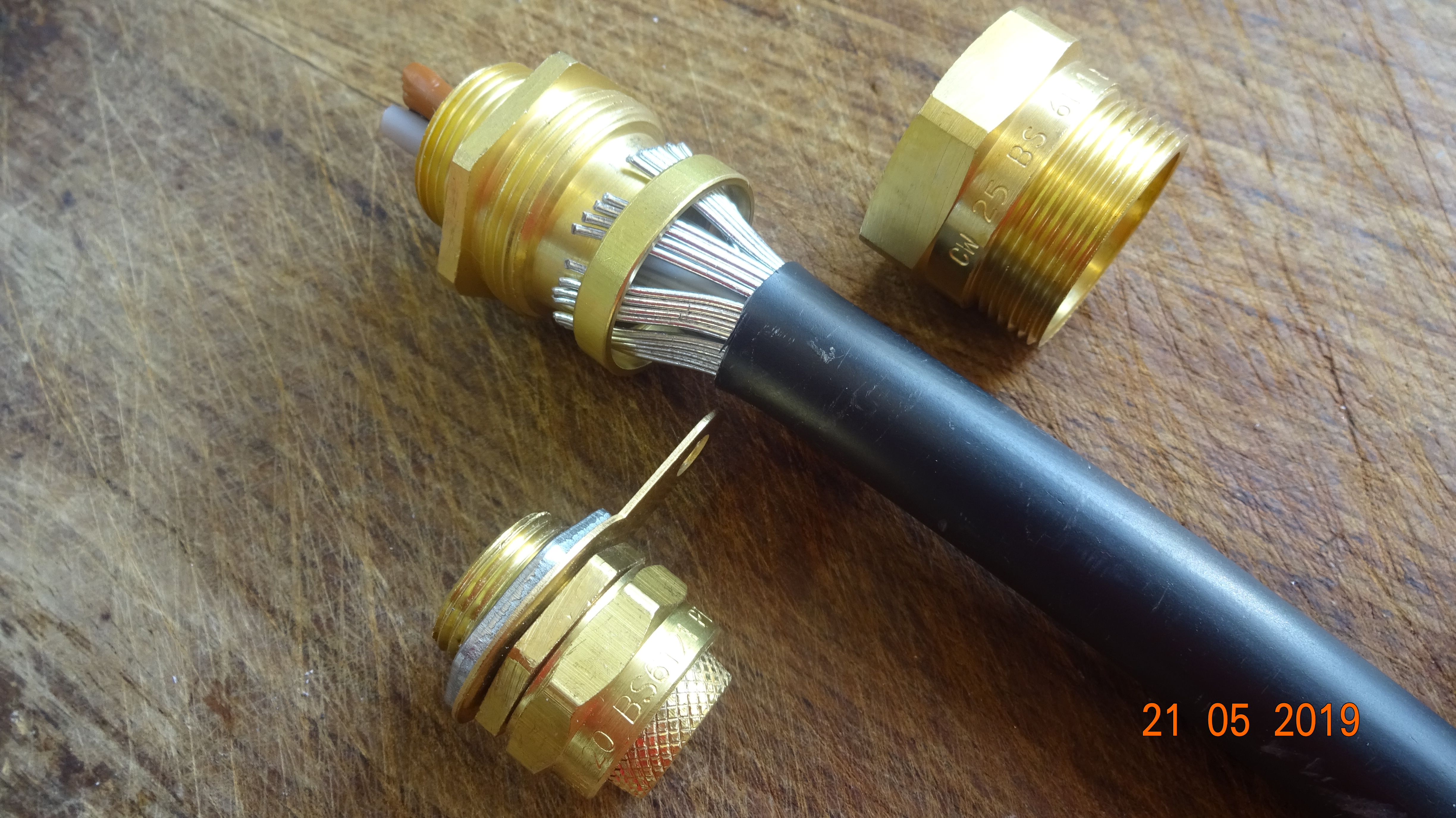

My question is: As far as I can determine, there are two types of gland for use on SWA cable: indoor and outdoor.
For a belt and braces approach I’ve chosen the outdoor type even though both ends will be indoors. The recommended gland for 10mm cable is Niglon 25CW.

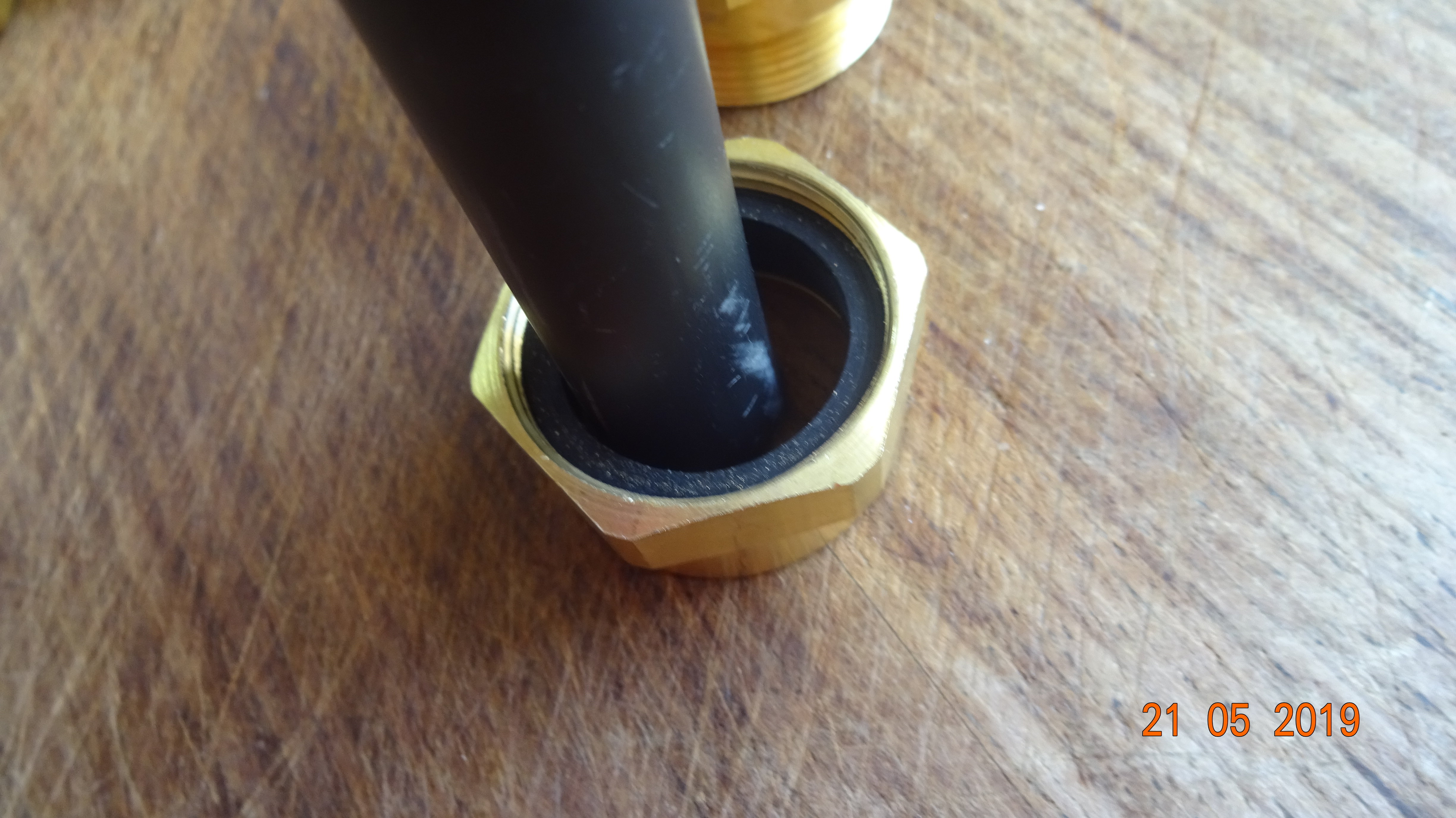

This gland has a compressible rubber/neoprene ring which provides the higher IP rating. However from the pictures you will see that it will never compress sufficiently to make a seal on the cable sheathing.
OD of Cable 18.9 (measured 17mm). ID of Compression ring 24mm.
I realise these glands are for a variety of cable sizes but the next smaller gland isn’t big enough for the 10mm cable and this one seems far too big.
Do I have to apply large amounts of tape around the cable sheath for the gland to compress? Or am I missing a trick?

Those are the wrong size glands; the compression ring should be a much tighter fit.
I normally rely on my wholesaler to provide the correct size gland and cable. Where did you buy them.

I purchased them from TLC-Direct. Think they were recommended on the same page as the cable.

also bear in mind that SWA glands come with 2 sizes of compression rings/entries. e/g. there is CW20S and CW20L.. the S and L identifying the size of the compression hole. Small or Large.
