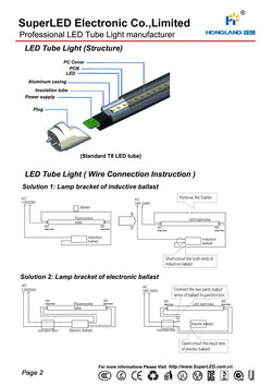

Looking for help converting T12 fluorescents to LED. Have a bunch of these in my basement and wanted to confirm the correct type of LED tube to get - single or double ended. Each fixture has 4 of the 4 ft T12s and 2 ballasts. Hopefully the pictures help.

My preference is to remove the ballasts and rewire.

Correct, led tubes do not need ballasts, if the input voltage of led tube is AC220V/110V, then just rewire directly.
Thanks! To get my bearings around this, from the set up in the pictures would you recommend wiring as single ended?
That's OK.
Hereby I send a T8 tube Wiring diagram for your reference, simply speaking, LED tube does not need a ballast and starter, you can cut all wires except that from electric box. There are two types of led tube, one is double-ends input, you can connect each wire to each sides. The other is single-end input, you can connect two wires to the 2 pins of the input side(Import: first of all, you shall confirm with the Tube supplier which end to be put).
