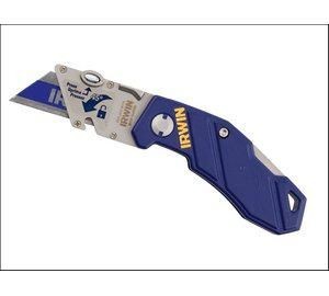

this is the only stanley worth having
[ElectriciansForums.net] the most important tools for starting off!
ive got stanley, haulfators etc but always go back to these
