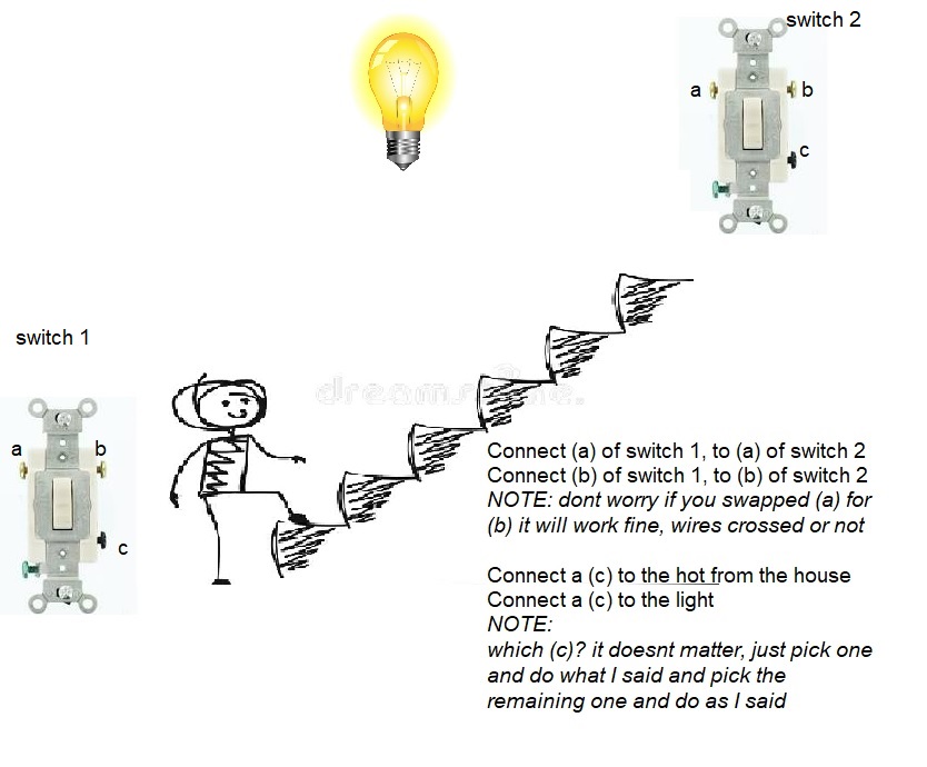

Do I need to have 2 power sources if I have a three way switch and a single pole switch in the same electrical box? The three way will have another switch at a different door for inside lights. The single pole will be for an outside light.

With traditional 3-way hookup there is no permanently live hot wire at the far end (door 2) to power an independent light via the 1-way switch, just the travelers and neutral. With 'Coast 3-way' there is a permanent hot, but no neutral. So, either you must run a separate feed with both hot and neutral for that outside light, or you will need at least four wires between the switches excluding ground whichever configuration you use for the 3-way: (hot, neutral, 2x traveler) or (hot, neutral, 3-way switched hot, switch common.)

Thanks for your reply. Your hose description is good. Except I don’t think it addresses my issue. I’m not asking about the light controlled by the two three way switches. I’m asking if there is a way to get power from the second switch, or Y in your example, for another light and switch that is not controlled by the three way switches. The three way switches are for an inside light. I want to also have a switch for an outside light from the same box/location.
As per my post #6, if your existing cable to the far switch position is 3-wire with ground, there is no way it can serve both the 3-way and the far 1-way by itself, using conventional switches. At least 4 wires plus ground are needed at the far end to provide the hot, neutral and two travelers.
However, there might be an electronic / smart 3-way switching option that requires only one control wire between the two switch positions instead of two travelers. If there is a neutral at the first switch position, the redundant 3-way traveler could then be re-purposed so that a permanent hot and neutral are both available at the far switch for the light on the 1-way.

ok, so here we are back at the Y example
[automerge]1598834577[/automerge]
[ElectriciansForums.net] Three way and single pole
Now, your question is answered if you think on it. For a light to work, we need a hot and neutral.
In my picture, my Hot and neutral are located downstairs.
If I want to tap off of all this for some other light somewhere, or an outlet or anything, I will need to grab it at that downstairs area where the hot and the neutral are.
If I were to try and grab my new light or outlet from UPSTAIRS at switch 2, I actually wont have a HOT and neutral. I will only have the two oranges (a) and (b), and a wire going to the light (c). when Im at switch 2, those are called travellers(a) and (b) and a switchleg(c). NOT a "HOT," and thats what I need. A HOT.
Done deal
