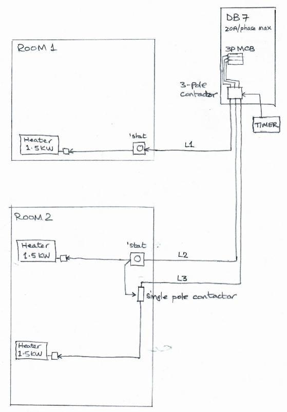

I'm fitting oil-filled panel heating into two rooms of a remote workshop, with (currently) a 20A x three phase supply.
Control, for occasional use only, is needed as follows:
1. A wall-mounted and easily-adjustable mechanical timer to set all the heating to come on an hour or two before people arrive.
2. Room thermostats to control temp in each room individually. Room 1 has one wall thermostat and one heater; room two has one wall thermostat and two heaters.
Due to supply limitations each heater must be on a different phase.
The block sketch below was knocked out by me over breakfast. I am not proud of the graphical standard :)
I'm unhappy with the second SP contactor. It feels clunky, over-complicated and ill-designed. I could of course fit a second thermostat in Room 2, simplifying the logic and deleting the second contactor, but that's even worse.
As always in life: Is there a better way of doing it? :)

Room 2 I would switch both by way of the contactor. ...
You mean use a 2 or more pole contactor, for consistency? Can't be on the same single pole contactor as the two heaters must be on different phases.

All clear now. You can run two phases through a four-pole contactor, two lines and their neutrals. Using a four-pole gives termination points for the neutrals and supply it using a four core cable.
Thanks, gentlemen, for the comments so far.
Unless someone comes up with a better way of wiring this, without the multiple contactors, I think I'll fit two wall thermostats in Room 2, one for each heater. It's the simplest, most logical way.
I suppose I can justify that by it providing the ability to leave only one heater on very low, limiting any background anti-frost load in Room 2 to only 1.5kW.
