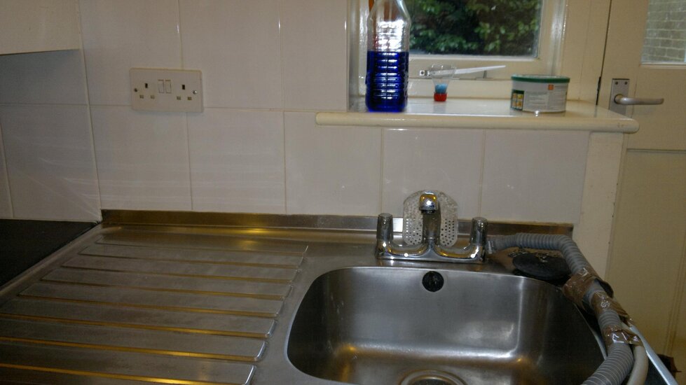

Been doing an EICR today and would value some opinions please:
The socket is well under 3m from the sink (yes I realise its not a bath or shower) so is this a code at all? Its actually a spur from a double which is in the cupboard so I could simply remove it.
The right edge of the socket is about 250mm from the left hand edge of the sink - code 2?

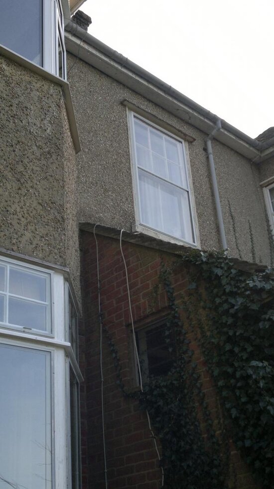

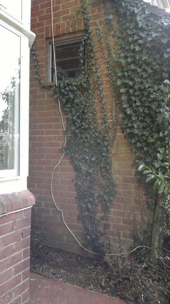

These pictures show an unsupported cable coming from another flats' window upstairs and down the wall by the "garden" area immediately outside the flat I was inspecting. Clearly this isn't part of the flat I was inspecting and is in a "communal area" so I technically can't code it and I was planning on a "written" observation.
Thoughts....
Thanks
