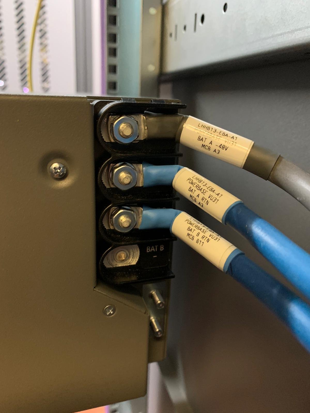

Some bright park in the telecoms industry has decided a new network operators passport scheme is a good idea, one card to show we have the required qualifications to be working on site. A bit like the CSCS card system, which we alreadyy have to have for a lot of customers. the NOPS card is £35 to start off with then £6 a time to upadte any qualifcations, bearing in mind some are annually such as asbestos awareness, manual handling etc, the costs soon add up. My annual training bill is the thick end of £200.
