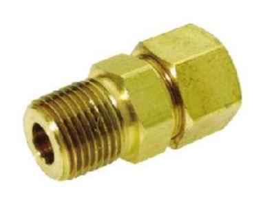

"Hello Colsey c",
Here is a Screenshot of a TracPipe 1" Male Iron Fitting - the Bonding Clip should be attached to the Hexagonal centre section once the TracPipe is fully installed / connected and Tested.
As these are Fittings where the TracPipe is `Flared`/ Seated by the operation of tightening the Fitting you should ensure that you don`t apply too much pressure to the Fitting when tightening the Bonding Clip / Clamp - as you do not want to disturb the Gas Joint - although it would take quite a lot of force to move the Fitting / TracPipe.
